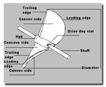

The bellow drawing (adapted from an original posted by Wayne Rathbun) shows a propeller parts:

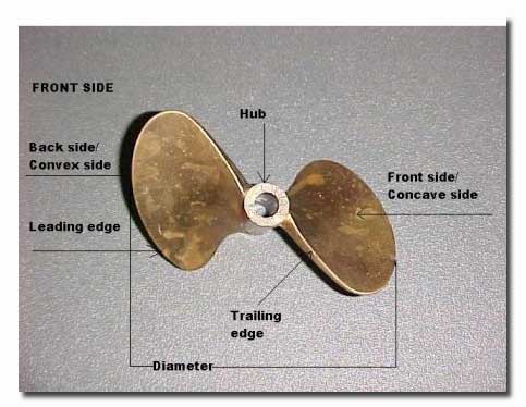

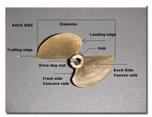

Same parts, on pics this time:

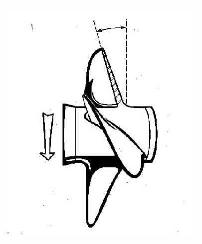

Rake: Is the angle of the blade attachment to the hub, and the degree that the blades slant forward or backwards. It's normally use to correct ventilation or cavitation situations. Furthermore, rake lifts the bow and so the speed. Typically, low rake props are used on sub-surface drives with heavy hulls. Higher Rake blades with surface drive application, tend to re-direct and condense the thrust cone further aft.
