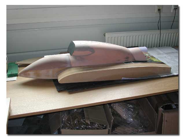

I’m not able to put the whole history of making the plug, building a mould and laminating the hull into words, so please check the pictures for all details:

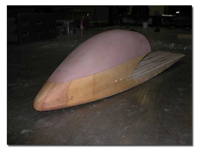

First work on the cockpit …
… and ready for the next step.
here you can see, why it means plane

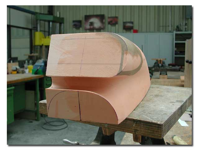

The air intake is growing up …
… and ready for the plug
it begins to look like a hydro

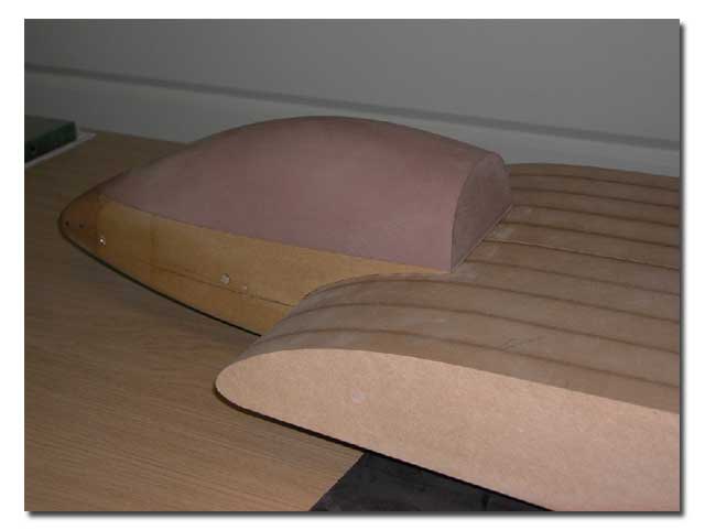

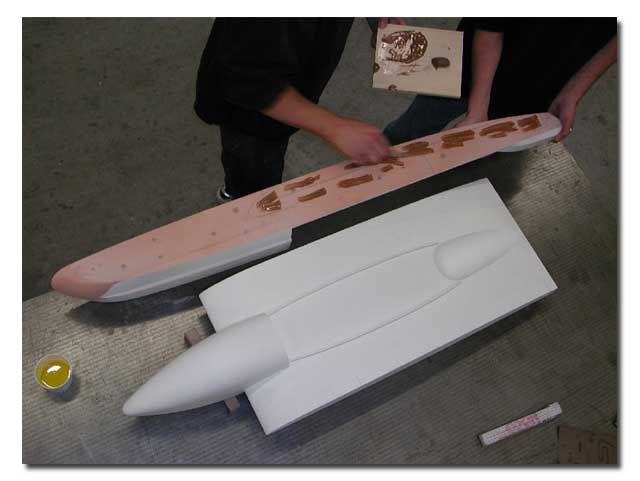

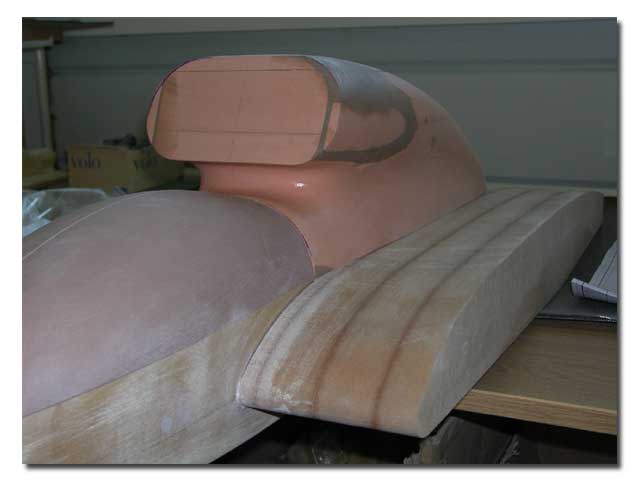

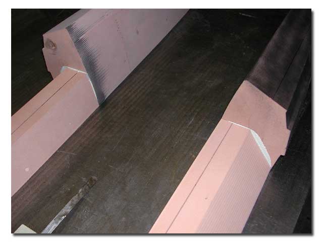

making the sponsons
checking the fitting of the sponsons

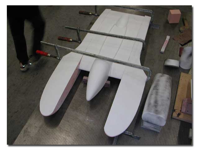

gluing the sponsons to the hull
Fixing the sponsons to the hull during the gluing
And it looks more like a hydro

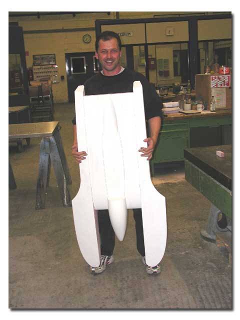

What dimensions! Chris together with the plug
More details of the hull
And the plug is ready!

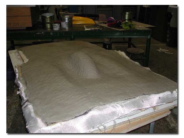

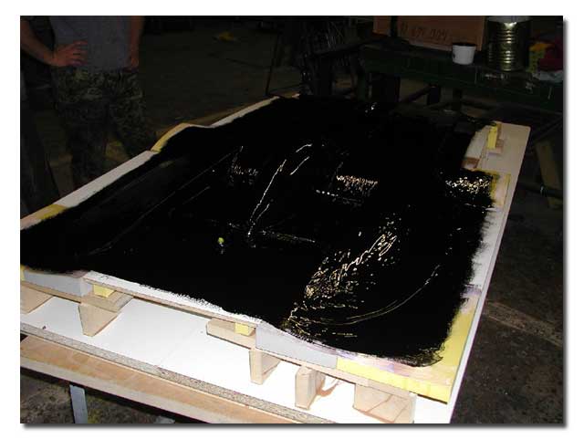

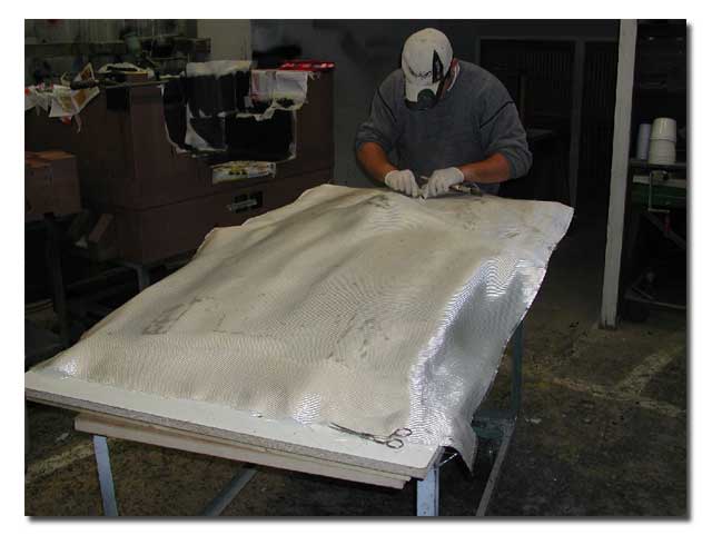

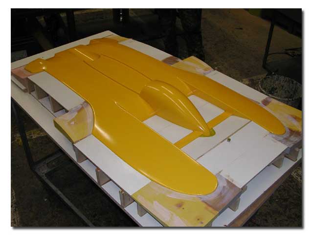

How to make the mould
First layer of the special mould resin
Some glass clothes
A thick layer of moulding ceramics

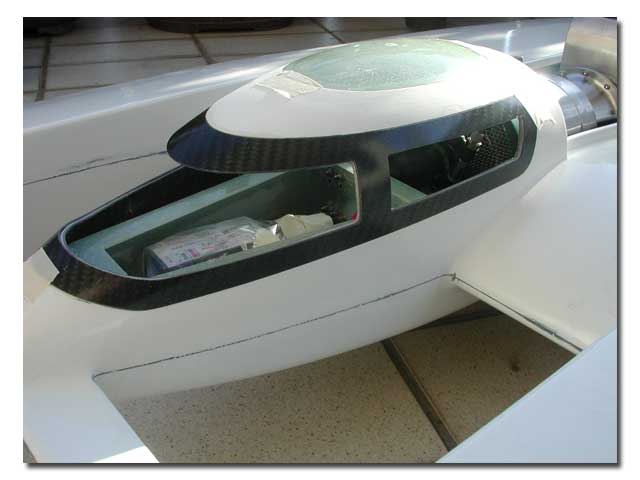

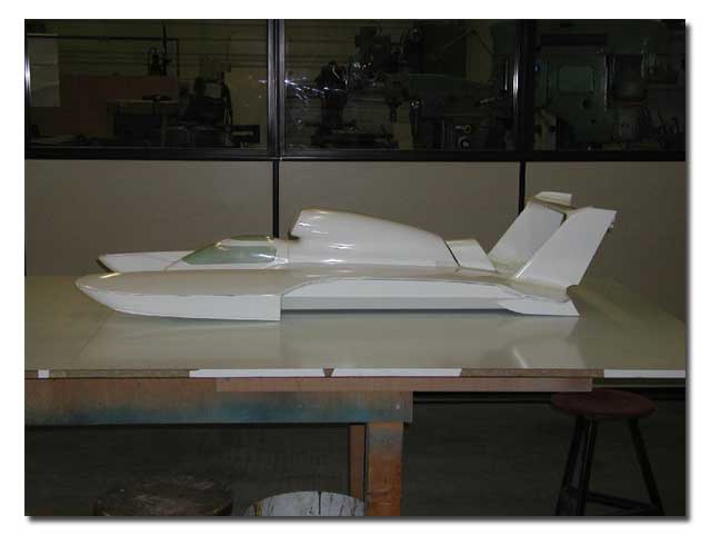

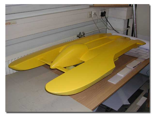

And this is the result: The first hull out of the mould, no seams, note the window frames! All made from carbon and epoxy. Every stressed area is reinforced, every bolts and nuts to fix the additional parts are glued in place.
Side view

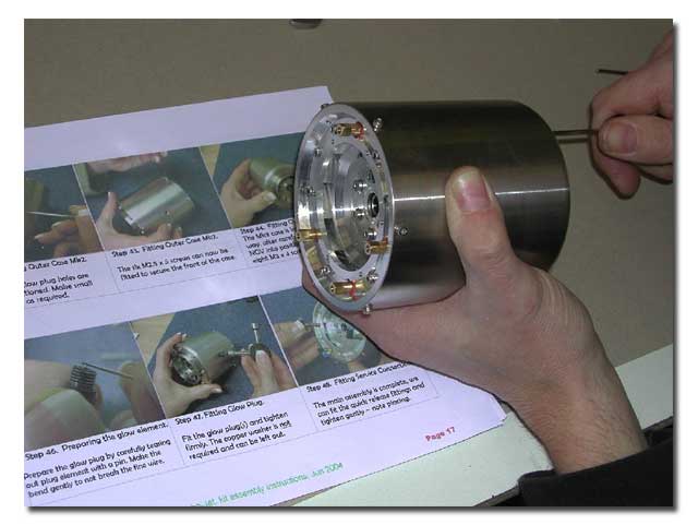

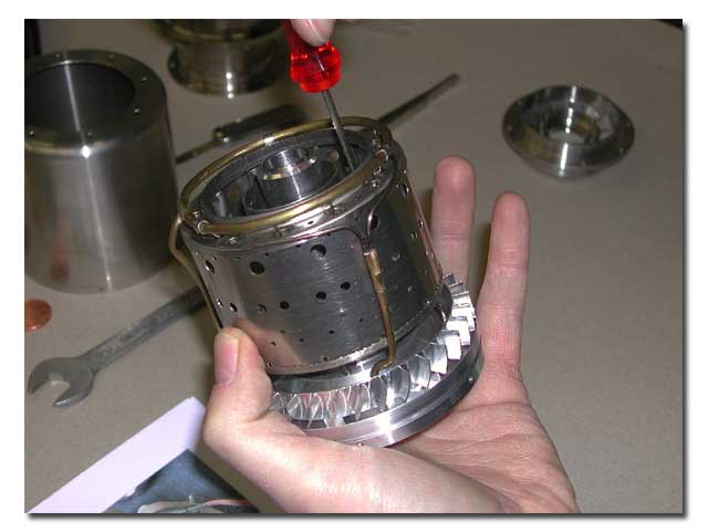

The second chapter will show you the engine. And this is nothing for beginners. The engine comes as a kit. You have to assemble it on your own.

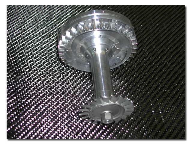

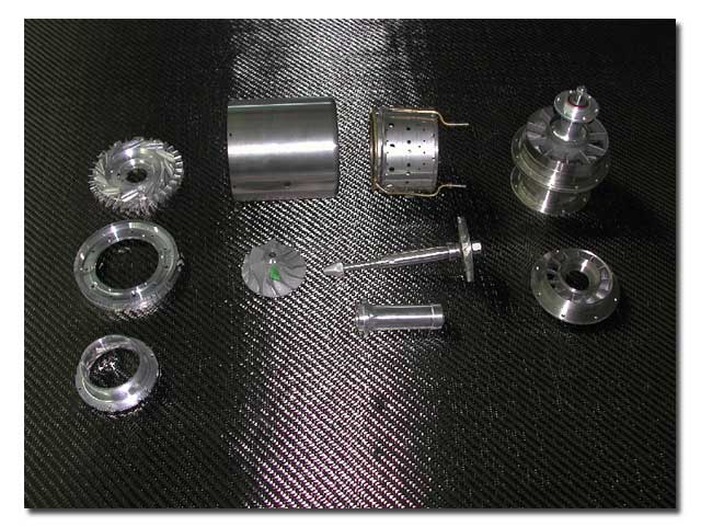

The turbine fan in the first chamber turns with a maximum of 160,000 rpm. In the second chamber the burned gases turn a second fan which is installed on an own shaft. This chamber and the both fans inside are designed in that way that the full power goes on the second drive shaft. After that the burned gases have no more power. This is how a turboprop with 2 prop shafts will work. The second prop shaft works on a gearbox to gear down the high rpms to 60,000 rpm. The second gearbox gears down to a maximum of 26,500 rpm for the prop. Here you have the power of real 9.5 hp, enough to turn a high pitched prop. The turbine burns kerosene or petroleum with 3 percent oil. It uses 5 to 6.5 ounces per minute.

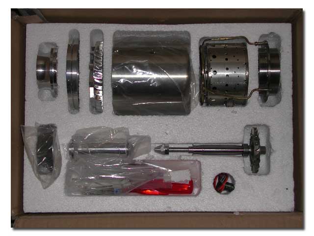

This is what you get for your money
CNC machined parts, everything comes in high quality
The rotor, note the blades of the fan
Very good instructions, complete with pictures

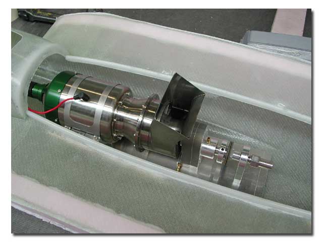

The complete unit, left the jet in the middle the touch less clutch with 2 fans inside to turn the prop shaft, after that the exhaust, on the right gearbox and brake to stop the rotating prop shaft during launching the boat
The jet inside the hull. Note that Chris has built just an own hull section for testing the correct placement of the engine and for first test runs

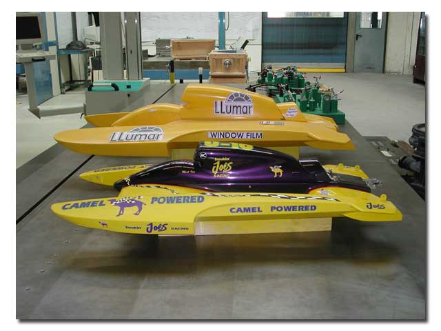

In the back the 1:6 hydro for the jet, in front of it one of Chris’ 1:8 T-4 Wing hydros, powered by an .90 nitro
Cockpit with radiobox, note the embedded window frames for a seamless window installation
