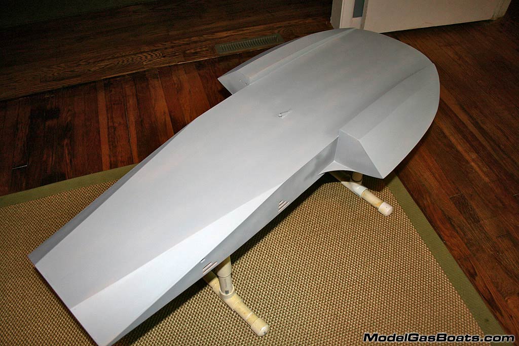

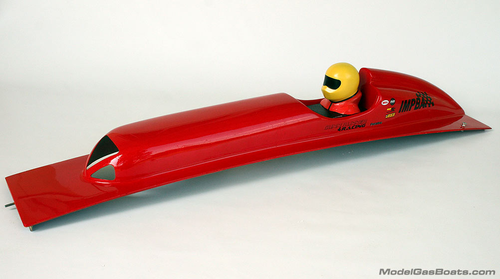

After sheeting is complete, and you’ve admired your awesome handy-work, grab the sanding block because it’s time to make some dust! I think I spent just as much time sanding the hull as I did building it. Taking this diamond in the rough and smoothing it down to reveal its mix of gentle curves and sharp edges is very rewarding. After all, it’s the finishing work that will separate your thunderboat from the next guys; take your time here. The Rockett is available with two different cowl materials. You can choose a raw fiberglass cowl which is light-weight but requires some finishing work, or you can opt for the gel-coated white cowl that’s super smooth and is a little heavier than the raw cowl. The latter still requires finishing, but considerably less than the raw one. I chose the raw cowl because I wanted to end up with the lightest boat possible for racing, which turned out to be right at 15.5 lbs dry …that’s the entire boat, not just the cowl …ok, just checking. After sanding, fill the tiny imperfections in the raw cowl and whatever you feel needs some attention on the hull with wood filler. I like to apply a small layer with a spreader then sand, and repeat the process. You’ll get good at this real quick!

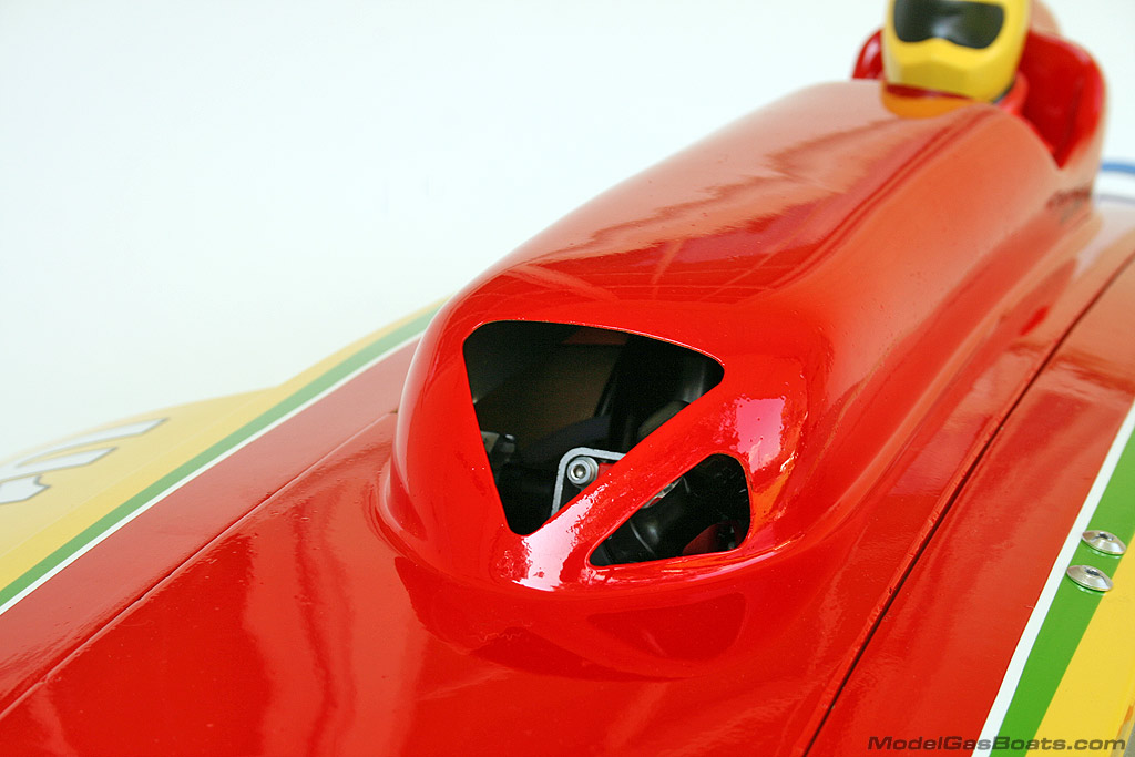

So you’ve skinned your hull, sanded the heck out of it, and filled any imperfections with wood filler. Don’t forget to cut air holes in the cowl because she’s got to breathe. Take your time here and draw out your intake with a marker then use a Dremel with a router bit or something similar to make the cuts. Afterwards, you can use sandpaper to clean it up nicely. Cut an exit for the hot air to escape in the dash area of the cowl, the bigger the better. If you don’t get the hot air out, performance will suffer, and so will your lap times. Now would also be a good time to drill some drain holes in the transom, one high on each side. Now that all your holes have been drilled, and all openings cut, it’s time to coat her in finishing resin.

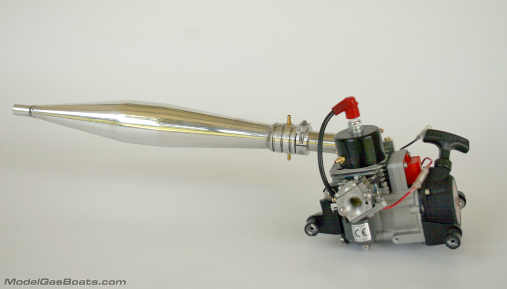

ImageYou have two options with a thunderboat; use a stock motor and race in a stock class, or run a modified motor and race in a sport hydro class. I chose the latter of the two, and my power plant of choice was the CC Racing Engines’ ProMod G260. The ProMod is an excellent choice for any hull-type, especially when paired with the Powermaster exhaust system, which we will get to shortly. The instructions for mounting the ProMod put the engine a little too far aft, and I was unable to get a good balance when all was said and done. Zipp Kits suggests you mount the engine so the carburetor is centered between the notch in the right engine rail. At this position, my Rockett required almost 20 ounces of weight in the nose to get it to balance around ½” behind the sponson transom. Keep in mind, everyone’s building habits will differ and the amount of resin and epoxy you use will affect the balance point. My suggestion is; wait to mount the engine last after everything is in the hull.
ImageExhaust systems can be tricky in thunderboats, and there are a number of options to choose from with the ultimate goal being to get the exhaust out at the transom. I chose CC Racing Engine’s Powermaster exhaust kit due to its aluminum pipe, no-leak flange, 2” band, and internal stinger. Basically, you get it all in one package! Choose the 90 degree pipe with no offset for this thunderboat, which fits very nicely under the deck. Because the motor is way up front in a thunderboat, you will be faced with a tuned pipe that ends around 11” before the transom. The easiest way to get the exhaust out is to use a flexible tube and Insane Boats' Thunderboat Transom Exhaust Kit is just the answer. It features a high-temp silicone tube, 2 pipe clamps, and a very nice looking flange to mount on your transom. To get the silicone tube connected to the Powermaster pipe, you’ll need to cut a hole in bulkhead number 3 for the tube to pass.

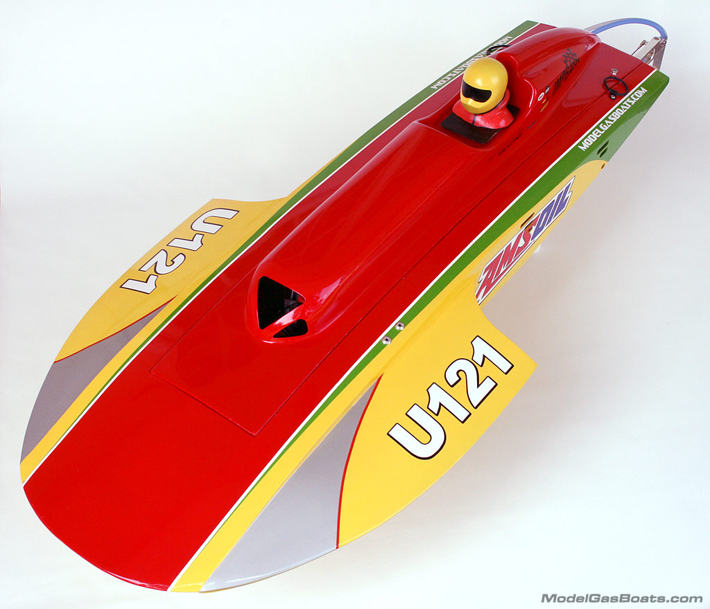

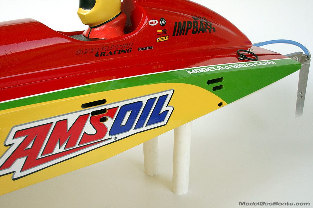

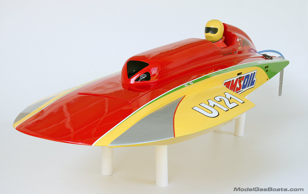

Here are some pictures of the completed boat with paint
Image  Image  Image
Image  Image  Image
Image  Image  Image
Image  Image  Image
Image  Image  Image

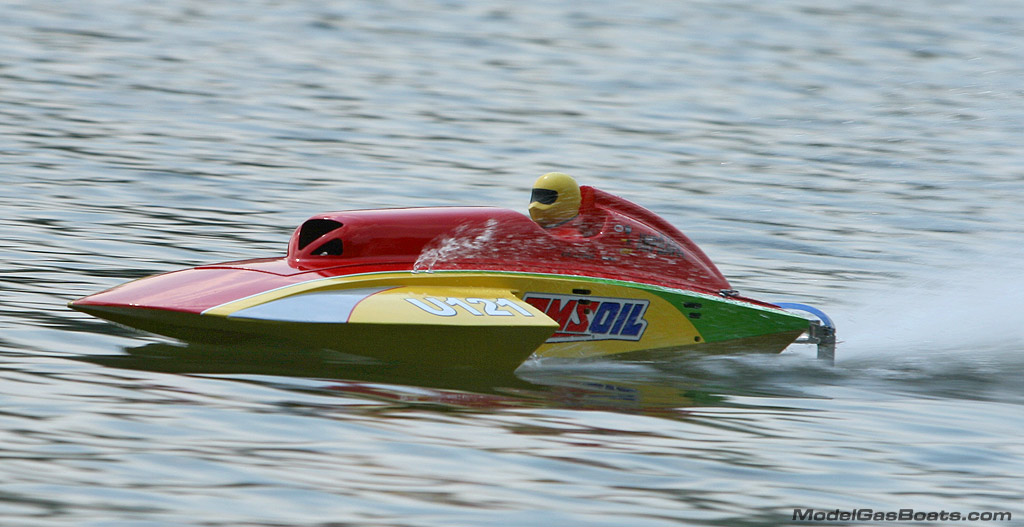

After a few problems with hopping in the turns, which fell on the center-of-gravity issue that I had totally overlooked, I got her dialed in to run the buoys quite well. I had originally started with 7016/2 prop but it had a little bog in the beginning of the straights that I couldn’t get rid of so I switched to a 6717/3 that really did the trick. The Rockett runs level in the straights and really carves hard in the turns. My only problem is with the fiberglass cowl; it’s a little weak and can get torn up if the boat stuffs or flips. Those running a stock motor shouldn’t have much of a problem. If you are going to run a full mod, I suggest getting the gel-coated cowl that’s a little thicker and sturdier.
The engine stays pretty cool thanks to the holes cut in the cowl and the small side vents near the pipe on the left side of the hull. They scavenge hot air from the pipe while also drawing water out when the boat turns hard right. I’m sure the oversized water outlets are doing their parts as well in keeping the motor and pipe cool.
