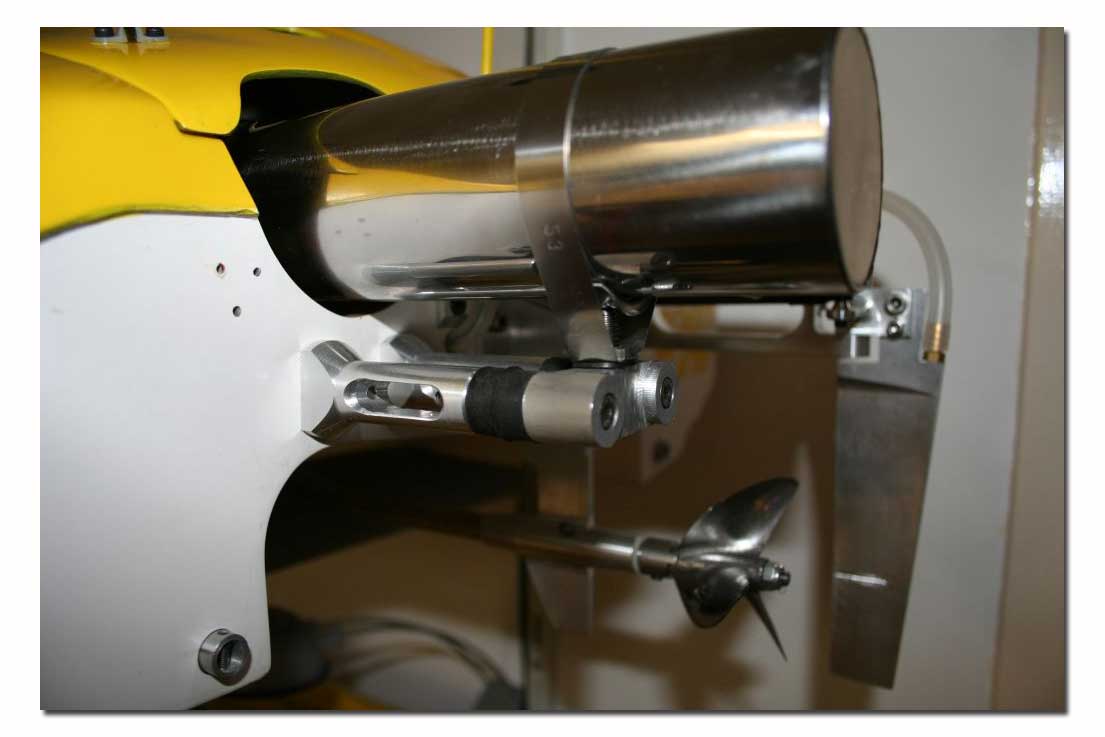

ImageMeanwhile, I learned a lot about motors and about tuning from several motor builders and started out the Jeroentune motorline for the European boaters. Then I met a guy who has a professional welding shop and I hooked him up with an AC Lazer 45. He was addicted ten seconds later. I discussed building pipes with him many times and this year we started a new pipe design. The pipe we finaly came up with is not realy much different than the "old "pipe we run withImage over here but the motors now develop more torque and my old design pipe does work perfect with the 260 motors . Also we played alot with the mufler, made an adjustable version to see how we could get better performance and used a spectrum analyzer to find out where the sound waves reflected and at what timing. We managed to find a sweet spot in the muffler to let the airflow bounce against its own cone to dampen the resonance. A kind of push-pull technique. It brought the sound pressure level down 3 db s but I was afraid it would hinder performance. After two test runs on water the db level was under 80 db and performance was like no other. The pipe is 1 inch shorter and the side stinger is longer than the first pipe.

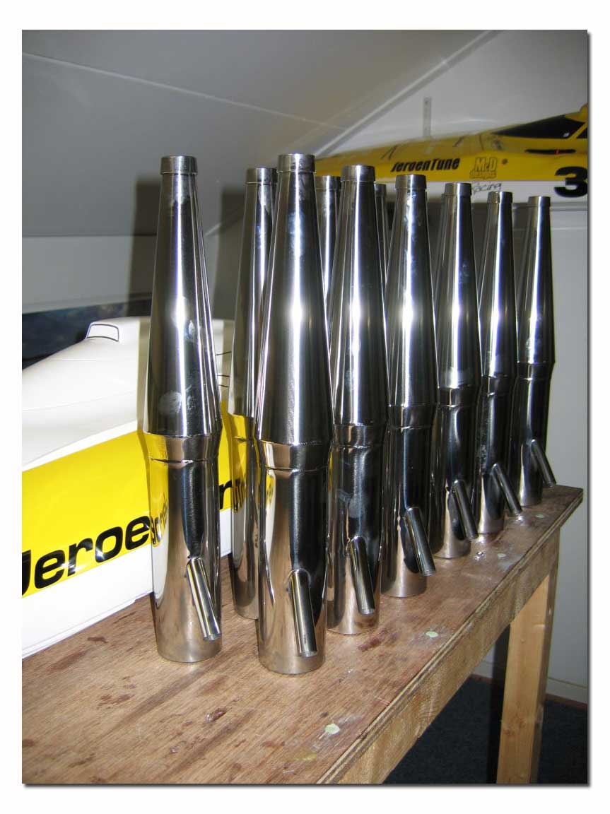

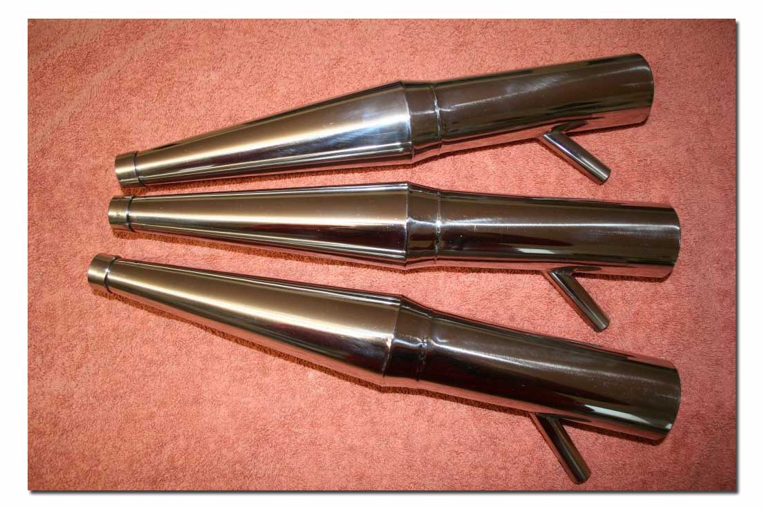

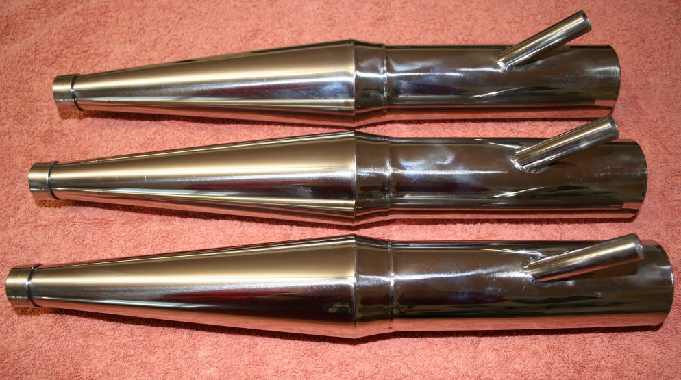

Then the building and welding started. We used stainless steel of 0.5 mm thick (thin). Instead of hard soldering some parts, we welded everything. But then the welder wanted to make it look like a jewel. I told him that it was just a model boat pipe, but he had this in his mind that it should look amazingly good. After making more than 25 molds for all the parts of the pipe and where to bend and roll etc, we found a way to weld them in a way that you could not see any welds in the line of the pipe itself. The only welds you can see is where the two cones meet. Still strong and no tension on the parts .
ImageWe sell the pipes with and without headers. This gives almost everyone a way to setup their boat with this pipe. The headers and flanges are comming soon. They are CNC manufactured and consequently pretty expensive, but worth the money. The first 25 pipes are built and about 10 of them are in use as we speak. The pipe seems to be popular in the states because the noise is so low and still a good performer. Dom Mauro is running an older version and is testing the new one. Even Andy from AC Model Boats has one and Marc Levac will receive one very soon. The waiting list is growing and so is the mailbox.
