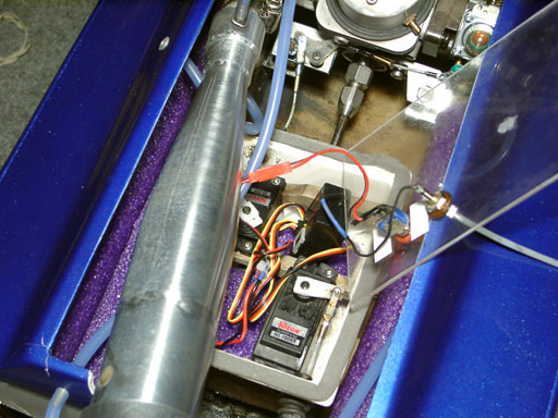

  • Now, if you've taken on water in the radio system, you'll have more work to do. Remove the batteries, dry them off, spray them with Corrosion X, dry them well and replace/recharge them. Unplug everything from the receiver, remove the crystal, and open the receiver case. Dab excess standing water with a clean, soft cloth or paper towel. Spray the circuit board liberally with Corrosion X and dab excess with a towel. Let it sit while you open the servo cases and do the same procedure to their circuit boards. Again, a light blow with compressed air is handy here. Wipe the excess protectant from the components and reassemble the servos and receiver. Prior to re-installing them, now is a good time to re-evaluate your radio box! Take it out and make sure it's watertight. Poke a couple of control rods into the exit points and dunk it in the sink! Seal up any leaks and you'll save yourself an encore of what you just went through. It is less expensive to check and re-check your radio box than it is to keep replacing damaged radio gear.

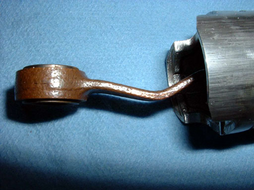

  • If you find the engine just won't run, you may have suffered further damage than is visually evident; bent or broken connection rods, piston wrist pins, rings, etc. are not uncommon when an engine ingests water and gets hydraulic locked - trying to compress the unyielding liquid puts tremendous stress on moving parts. An entire teardown and rebuild may be in order. Don't be shocked if it's necessary! Unfortunately, this can be a very costly exercise; if the connecting rod is bent, the whole crank might need to be replaced. The cylinder head can be damaged if the mounting "ears" on the jug are bent due to the force. Often the piston, wrist pin, wrist bearing, crank and cylinder head need to be replaced! Sometimes, it might be cheaper to just buy another motor.

  • OK, now that you know what to do should "IT" happen to you, take it to heart and do some preventative maintenance before the first launch of your next new boat. Make sure your radio box is watertight! Spray everything (excluding membrane or keypad type switches) with Corrosion X or similar type product. Keep your receiver dry by spraying it down with Corrosion X, filling it with bees wax or wrapping it in a balloon or condom (yep, that's right). Do the same with batteries. Douse servos with Corrosion X before installing them in the boat. Use good grade radio box seals and keep them well lubricated with silicone or other waterproof lubricant. You can even add water absorbing material to the radio box to help reduce the possibility of the electronic gear getting wet.

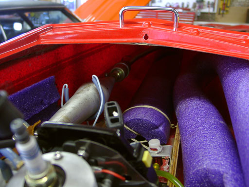

  • ImageFloatation: This is a tricky subject, and opinions differ greatly. The bottom line is; use plenty of floatation that will not absorb water, and is not affected by gas or oil. Good options are pool "fun" noodles, 2 liter rigid plastic pop bottles (glue the caps on), some 2-part or partially expanding pourable/spray foams (avoid the "Great Stuff" foam found at hardware stores, it soaks up a lot of water), partially inflated beach balls, and many other forms of foam flotation. Be sure to attach the floatation securely. You don't want your floatation bobbing around by itself, while your boat becomes a submarine! If you run with a hatch on, be sure to add some floatation to it as well.
  • Many racers use just enough floatation to keep the deck above water, in an attempt to create less of a "target" for other racers. Some run with open drain holes in the transom, and open vent holes in the bow. If they flip or roll, the hull will take on water, partially sinking the boat. If they do get hit while stalled, they don't end up getting t-boned in the gunwale; instead, they might end up with a few prop marks on the deck!
  • By all means, test your floatation! Secure rocks or other weight in the hull to simulate the engine weight/location, and radio gear position/weight. Better yet, do a full dunk test, with radio box, motor and all. Flood the entire boat right side up (so air doesn't get caught in the hull), and see if it floats. Yes, water may get into the motor when you do this, but it will anyway when you first flip the boat, so why not try it when you can observe it easily? Put the hull in a pool or shallow pond area. Roll the boat over by hand and observe what happens. Try it with and without the hatch on. There is no gray area here: if it doesn't float well, ADD MORE FLOATATION! Better to be safe than sorry!
