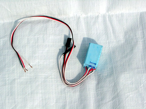

A variety of radio fail safes are available, but few are designed specifically for use in model boats (unless they are integrated into the receiver), where water can be an issue.
ImageThere is one fail-safe, produced by Shark-Racing, that is waterproof and it can handle all the failure scenarios described above. Carlos Andrade and his Shark -Racing team are on their 3rd variation of their fail-safe. This device integrates a radio fail-safe, a motor kill switch, a low battery warning indicator and the circuitry to detect a disconnected throttle servo. You can find out more about this wonderful device on the Shark-Racing web site (Carlos' site is unfortunately now down indefinately.)
I have a couple of these great fail-safe devices, but like seat belts and motorcycle helmets, they don't work unless you use them...

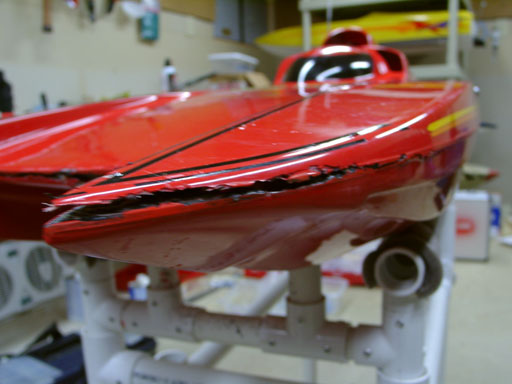

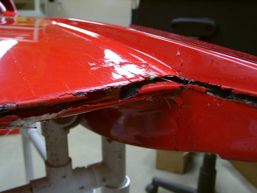

I recently built a new boat, and in my excitement and haste to rush out to the pond and give it a spin, I neglected to install my fail-safe device. And of course, Murphy hit me hard. During one of the runs, I was doing a high speed turn when my battery became disconnected from the receiver. I lost all control of the boat and it ran full speed into the bank and up into a small tree. The consequences of the crash are pretty evident--the whole front end was smashed in! This could have been easily prevented if I took the time to install my fail-safe device. When the power was lost, the boat would have stopped dead in the water.
In an instant this crash turned an expensive and "pretty" boat into an expensive "ugly" boat. Although IImage was upset at my own carelessness, I learned a valuable lesson. A small investment into a fail-safe can provide a priceless amount of insurance! A fail-safe can protect your boat, your peace of mind, and add to the safety of those around the lake. I can imagine a time in the future when fail-safe devices may be required equipment. In the mean time, it just makes common sense to use one.
