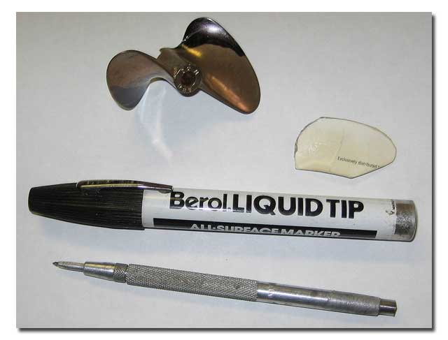

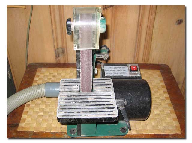

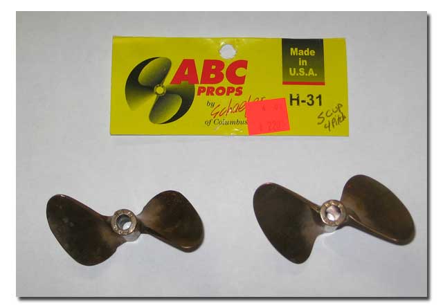

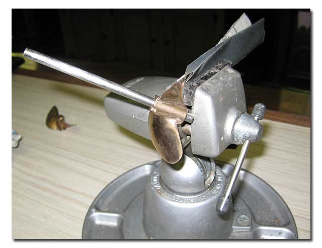

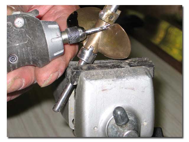

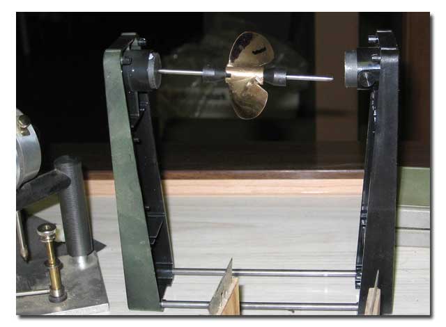

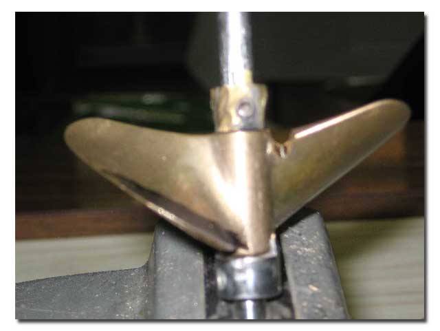

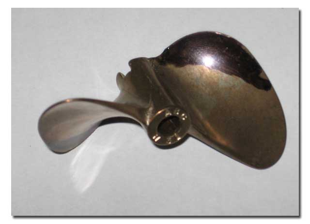

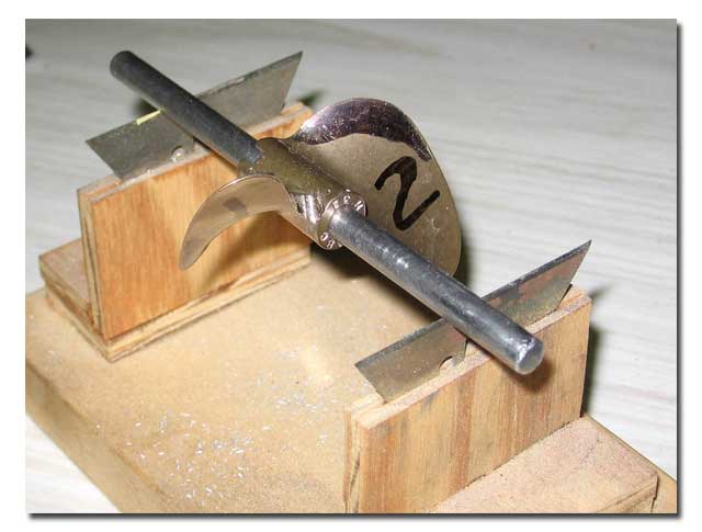

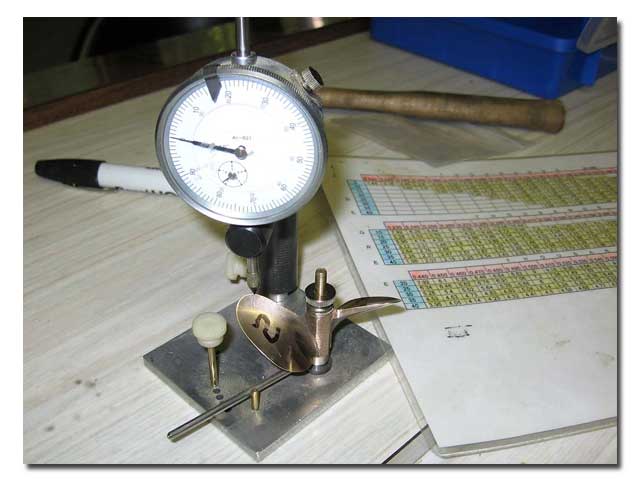

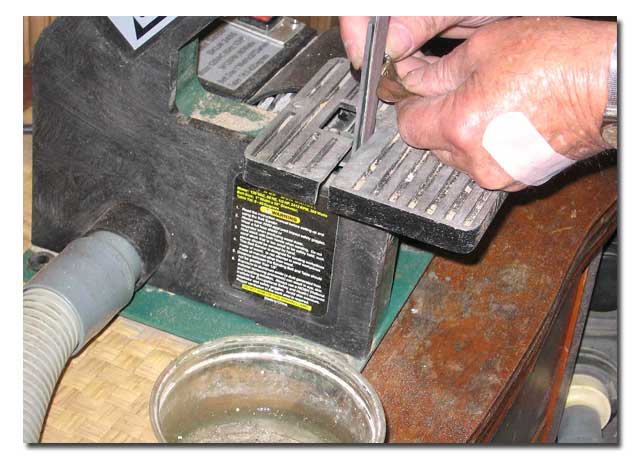

The ABC H-31 prop is a 70 mm diameter prop with about a 4.6 pitch. I am going to modify it for a Whiplash hydro. First step is to cut back the tongues. I mark up the tongue area with a felt marking pen and scribe the shape that I want from a cardboard template. I then trim the tongue back on a 1” belt sander. Mount the prop on a ¼” arbor with two drive collars. Hold the arbor in a hobby vise to backcut the blades with a 1/8” diameter carbide burr 1/8” deep at the root of the trailing edge of each blade. I then backcut the blades of the prop so there is 1/8” at the root and 0” at the tip removed. This is done on the belt sander so there is a sharp square edge on the concave side of the blade. The next step is to thin the blades and sharpen the leading edge on the belt sander. I have marked the concave sides of the blades #1 & #2 with a felt marker for identification purposes. When the blades are sharp and thin I start checking the balance. When the prop is balanced it is now time to finish the blades surface which I do with a little bit of filing if necessary and recheck balance.

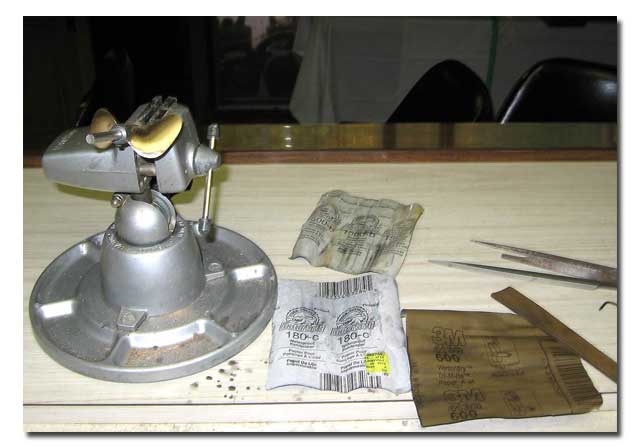

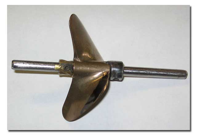

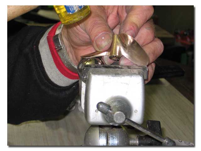

Finish with wet sanding, starting with 120 grit, followed by 600 grit and finished with 1500. I use a 1/8” x 5/8” stick wrapped with the paper to do this finishing and it is easy and quick. To re-pitch the prop use some 1500 paper doubled up in the hobby vise and grip the trailing edge of the blade. Insert a ¼” shaft in the bore of the prop and torque bend the blade. Check the pitch on the Rossi Pitch Gage and re-do until correct. In this case I wanted a 5.9 pitch on the last 20 degrees. A little spooning is necessary, as I do not think the H-31 had enough. The spooning increases the prop efficiency. I do this with a plastic hammer and a 1” diameter steel ball in the hobby vise. Only about a 1/32” is enough. Since most boats run surface drive and only the one blade is in the water at a time, any water that slides off the end of the blade lifts the stern of the hull creating lift. I would like to add that the 1/8 “ backcut reduces lift and is not necessarily desirable on some boats.
