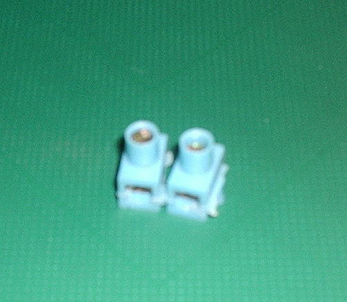

Get a couple of bigger type cable connectors (match size to carb needle)

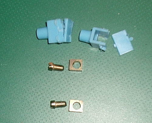

Cut them open and remove the parts

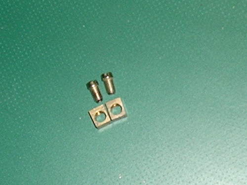

Clean them and grind them to size (if needed)
Step 4
Solder them together and clean them up

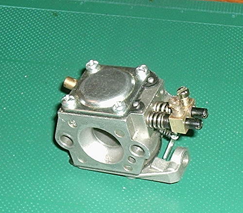

Mount the item
Image    Image
