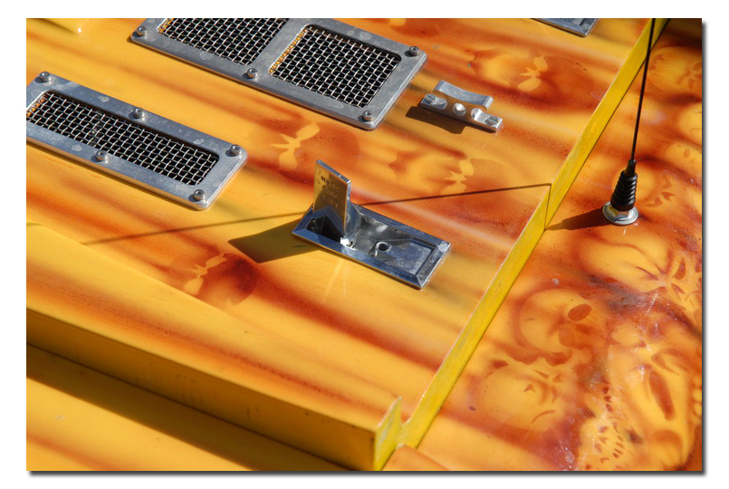

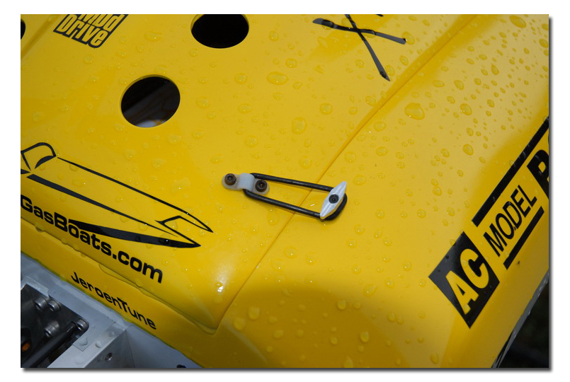

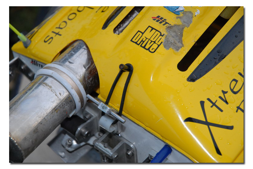

For the first way of fastening I found three solutions. Two of them consist of using o-rings, the other strong magnets. The first solution uses o-rings that are fixed to the hull by using a clamp. On the hatch there is a hook, usually a ball link, where the o-ring is attached to. When closing the hatch you have to put the o-ring around the ball link and it holds the hatch to the hull. Normally you find two o-ring fasteners, one on each side, on the back of the hatch.
The front of the hatch is fixed with some steel rods or mounting links what are glued to the hatch and fit under the hatch frame of the hull .This method is economical and uses parts that you can get in just about every model store. It is easy to handle and to install. But when you flip your boat it is possible that you damage your hatch and/or the area around the hatch frame in the front.

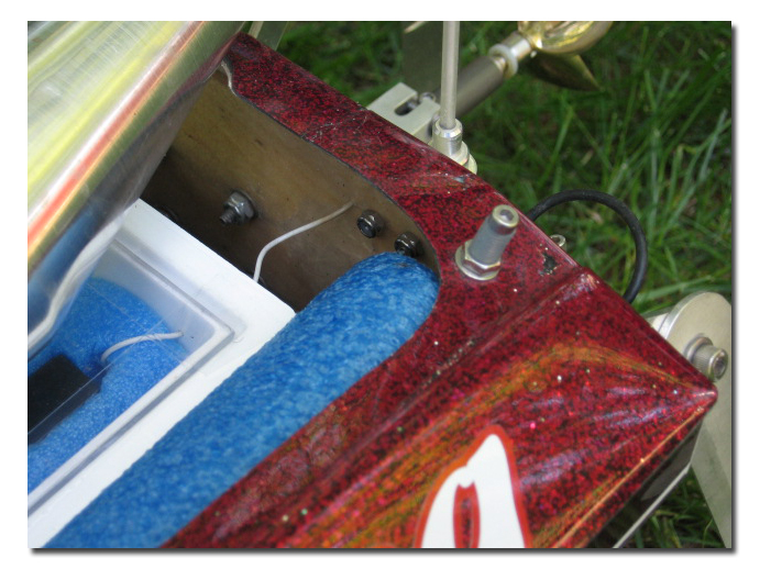

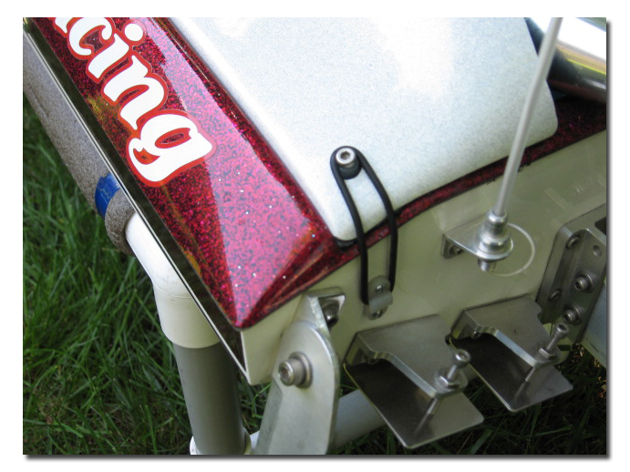

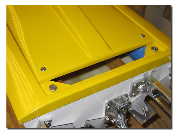

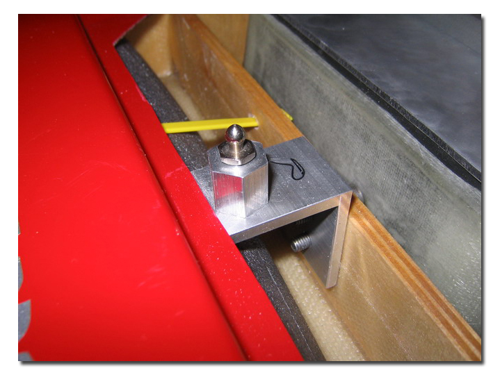

A little bit more time and effort is required for the method I saw used by Mike Tyson on his boats. Mike also uses the o-rings but he installs some bolts to the hatch frame on the hull on each corner. The hatch is drilled to fit over the bolts. When closing the hatch you only have to pull the o-rings over the bolts. The bolts hold the hatch in place, with no possible movement forward or backwards or to the sides. When flipping the boat the o-rings come loose and the hatch can break away without damage.

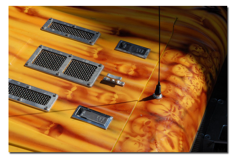

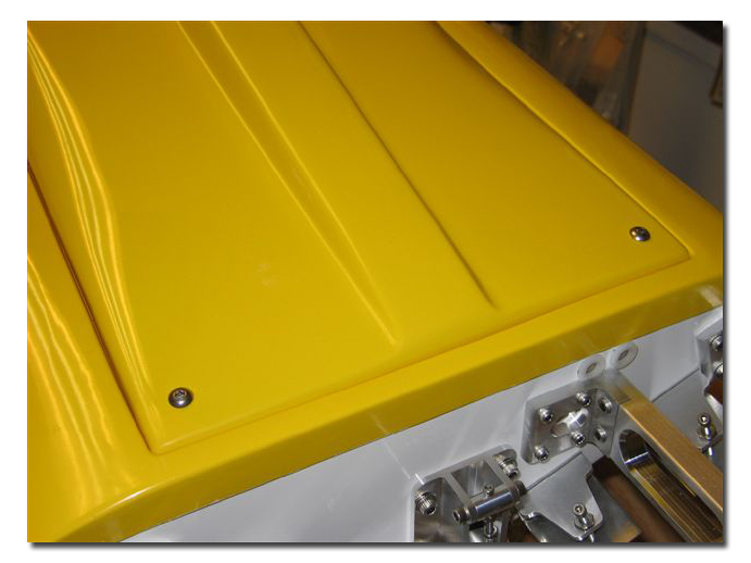

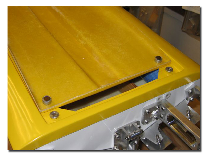

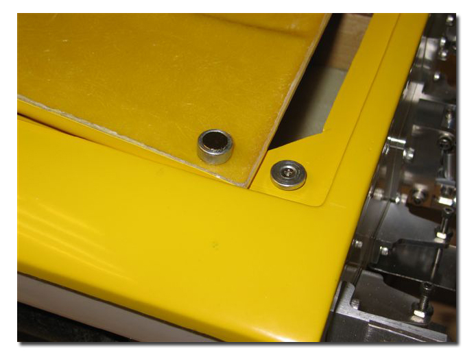

Using strong magnets such as rare earth magnets is another alternative. Again the front of the hatch is usually held with pins as previously described. The difference is that the back of the hatch is held firmly by magnets rather than o-rings. In the pictures you can see a kit sold by Herzog Racing Products and the way it looks once installed. This makes for a very clean installation when properly done.

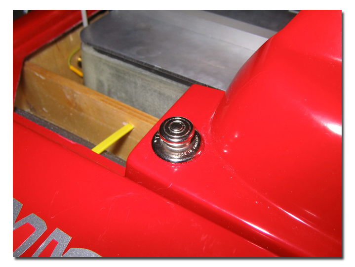

One way is to use TENAX fasteners. These fasteners are available at boat or RV suppliers. They are used for fixing canvas covers or awnings to the vehicles. The TENAX fasteners have a built-in claw that fits to a ball link. The connection is so strong that it is possible to lift the boat with the fasteners.

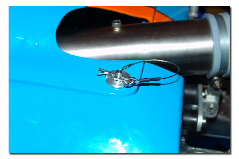

Next method is a spring fastener. This is a bolt that is held in position by a spring. By pulling back on the bolt the fastener opens. There are 2 different spring fasteners, one is installed to the hatch and the bolt locks under the frame and the other one is installed to the hull (mostly to the deck) and locks to a link that is laminated to the hatch.
Small spring fasteners are often used by RC pilots to fasten the canopie of airplanes. Bigger ones are available from MHZ or check your local home depot.
