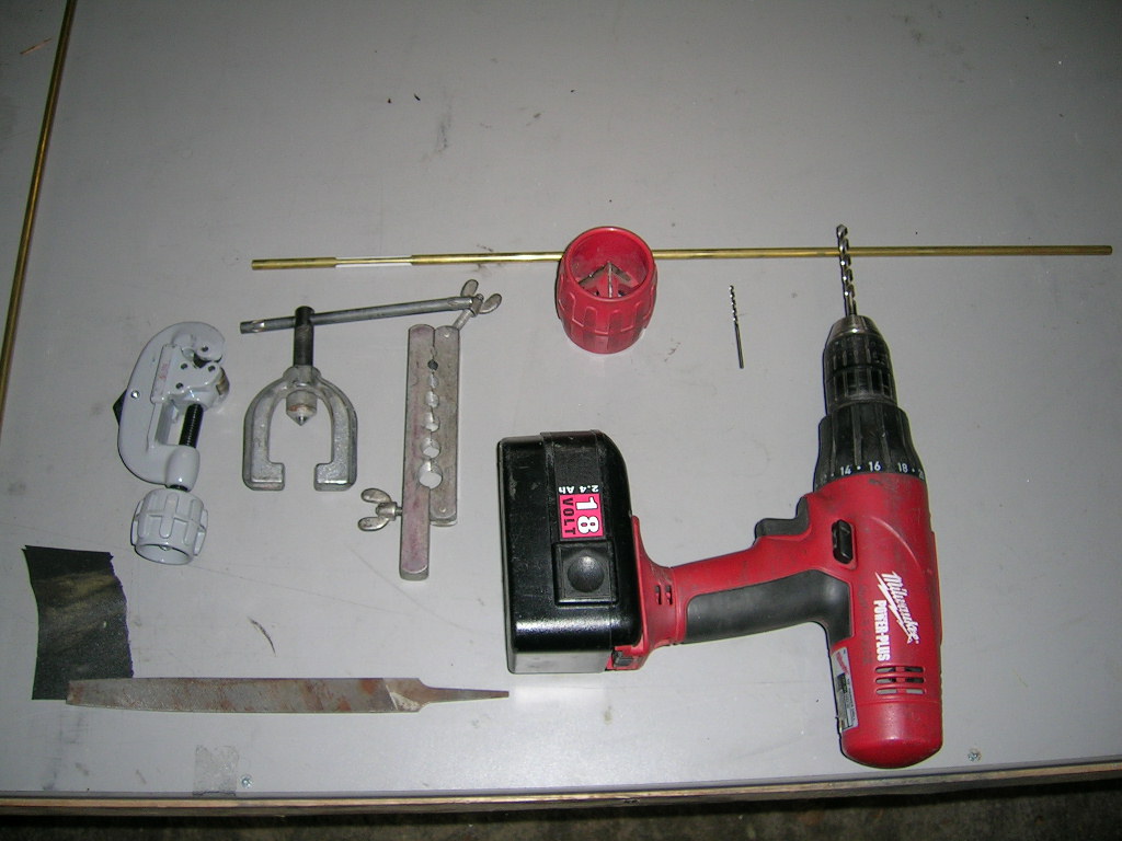

Here is what you will need to make your bushings:
  • 9/32" K&S brass tubing
  • tubing cutter
  • flaring tool (if doing the flared end bushings)
  • small torch and solder (for ring type bushings)
  • drill and drill bits
  • a file and some sanding paper
  • an Inner-Outer reamer (optional but handy)
  • a good pair of gloves will also come in handy
* if you do not have a flaring tool, do a search on Ebay...you can find some for under $20. The same goes for the Inner-Outer reamer.

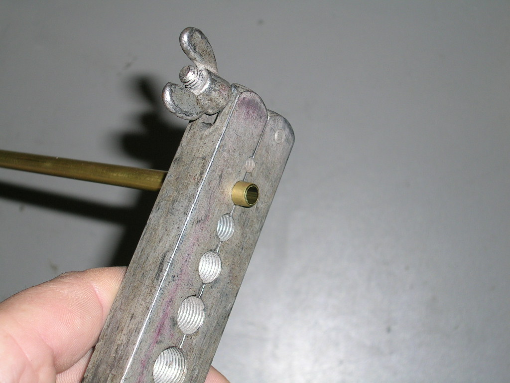

The first step is to setup your length of tubing in the flaring tool and do the actual flare. The sole purpose of the flare is to prevent the bushing from creeping inside the stuffing tube so it doesn't have to be very wide.

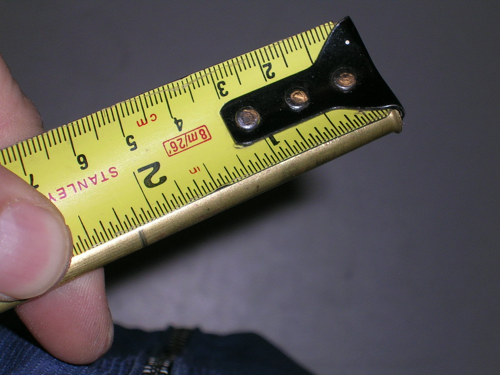

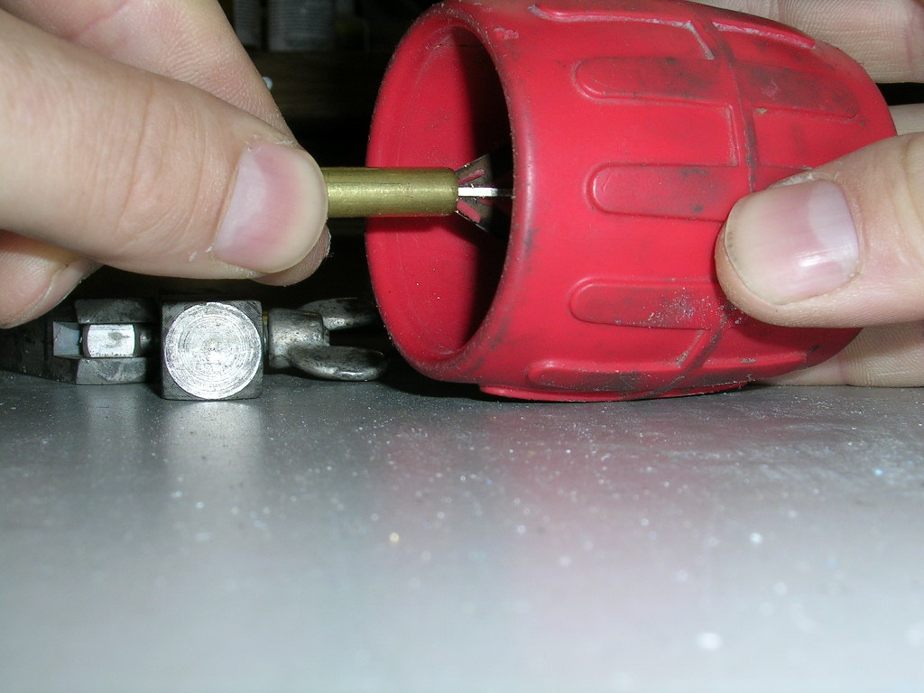

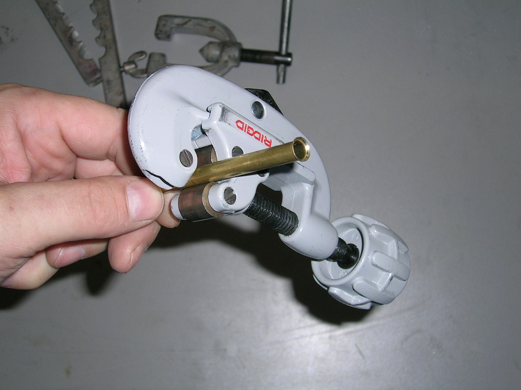

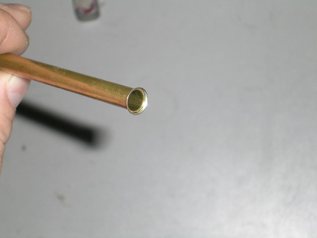

When you are satisfied with the flare, remove the tubing from the tool, measure and mark a line where you want to cut it. I make my bushings 2 1/8" to 2 3/8" long, but that is up to you and dependant on your setup. Cut it to length with the tubing cutter and deburr the cut end with the reamer.

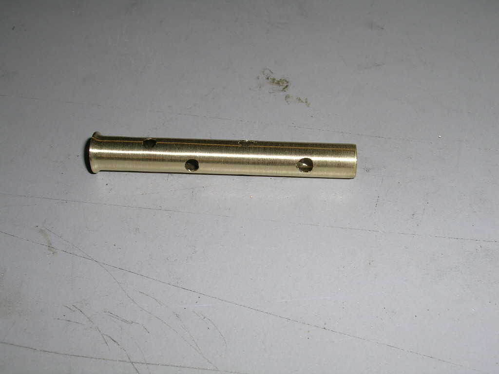

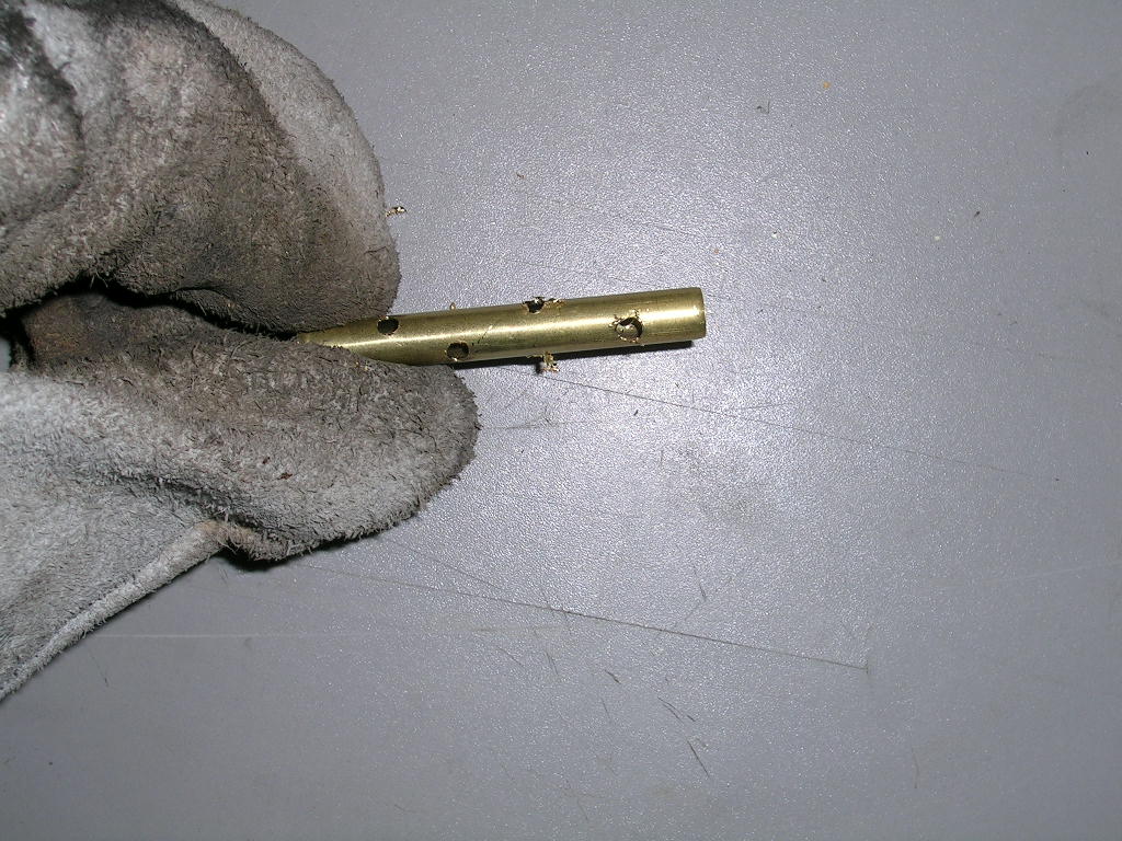

The next step is to cross-drill the bushing. These holes will help keep grease in the bushing to lubricate the prop shaft. I use 7/64" or 1/8" drill bits for this. The holes can be drilled using a hand drill or press drill depending on what you have at available to you. It really doesn't have to be accurate they are just for lubrication. On some bearings I drill all the holes lined up, on others I do them at 90 degrees from one another. Again just do whatever you prefer. I have not noticed any gains one way or another.

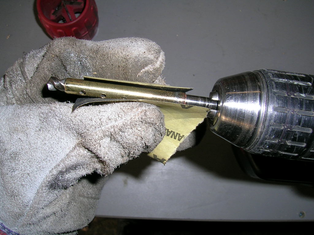

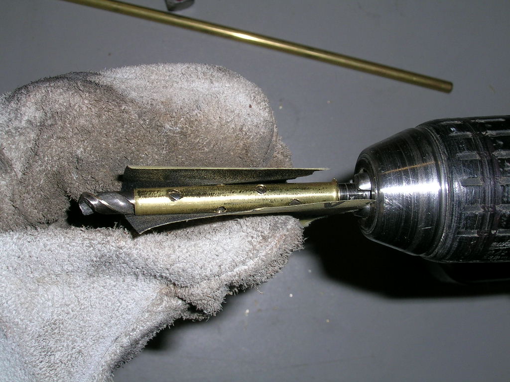

With the holes cross-driller, insert a 1/4" drill bit in your drill and run it through the bushing. Now is a good time to wear those gloves, as you will notice that the cross-drilling left a lot of sharp burrs. Use a file to lightly sand the bushing as you turn it with the drill. This is just to remove the burrs. The use a piece of sand paper (220-400 grit) to sand the bushing while turning it at high speed on the drill. Once this is done you can hold the bushing with your gloved hand and run the 1/4" drill bit through it several times to make sure the inside is deburred and clean of obstructions.

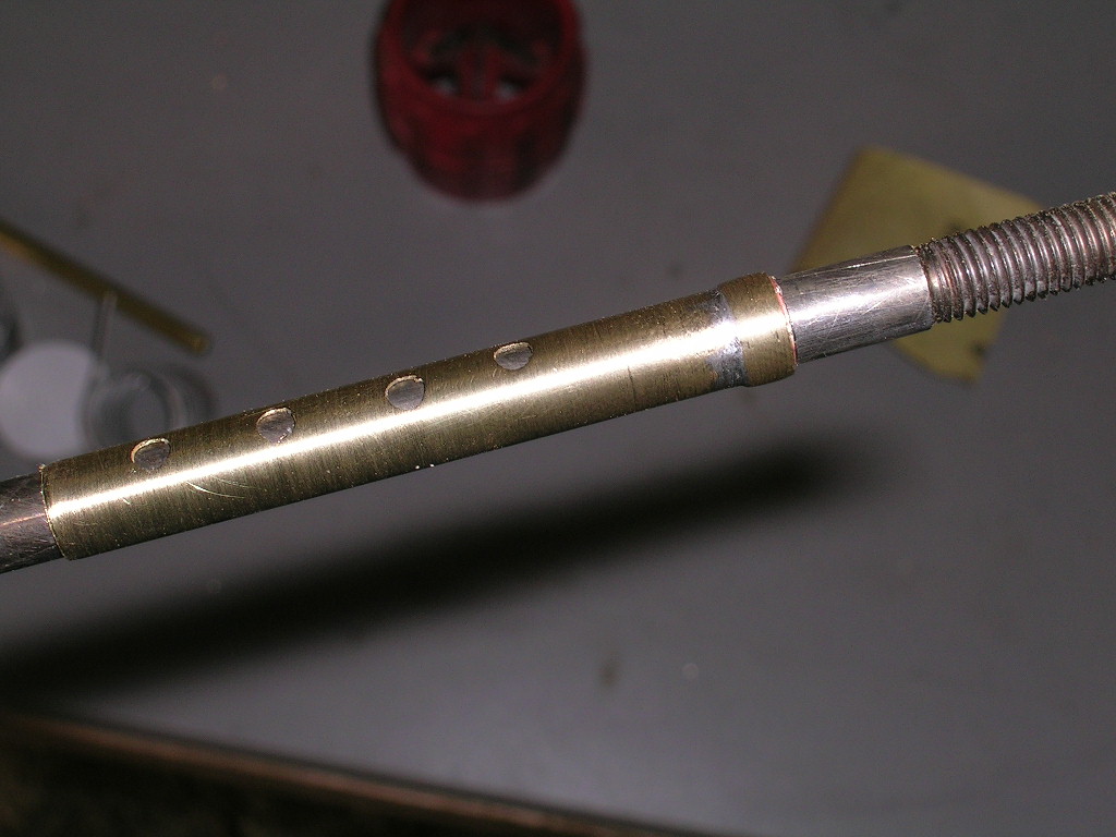

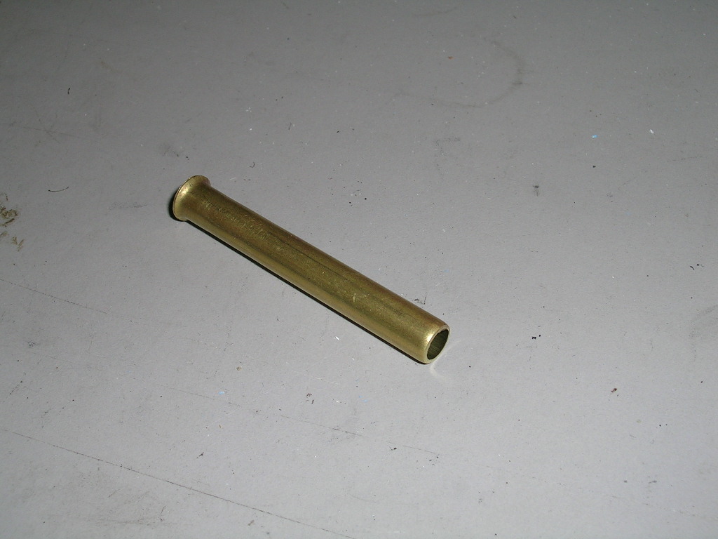

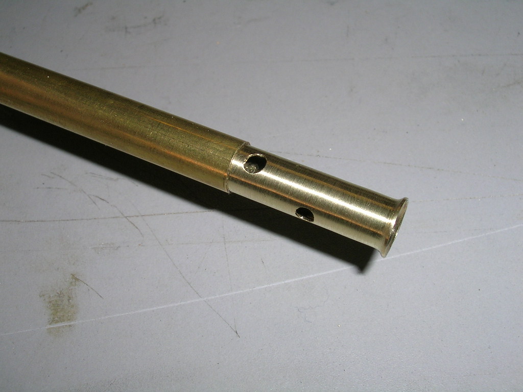

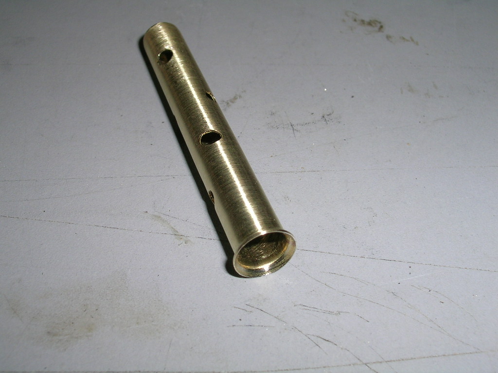

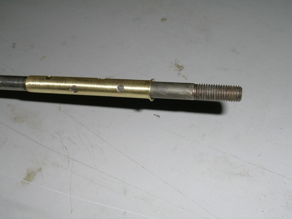

This is what the finished product should look like. You will want to test fit it inside a piece of 5/16" tubing (stuffing tube) to make sure it rotates freely. If it doesn't, put it back on the drill and sand a little more with the sanding paper. Test fit again. You want to test fit it on a prop shaft also. Again, it must rotate freely. Not excessively loose, but just freely. If it doesn't, run the 1/4" drill bit through it some more until you get a good fit on the prop shaft.

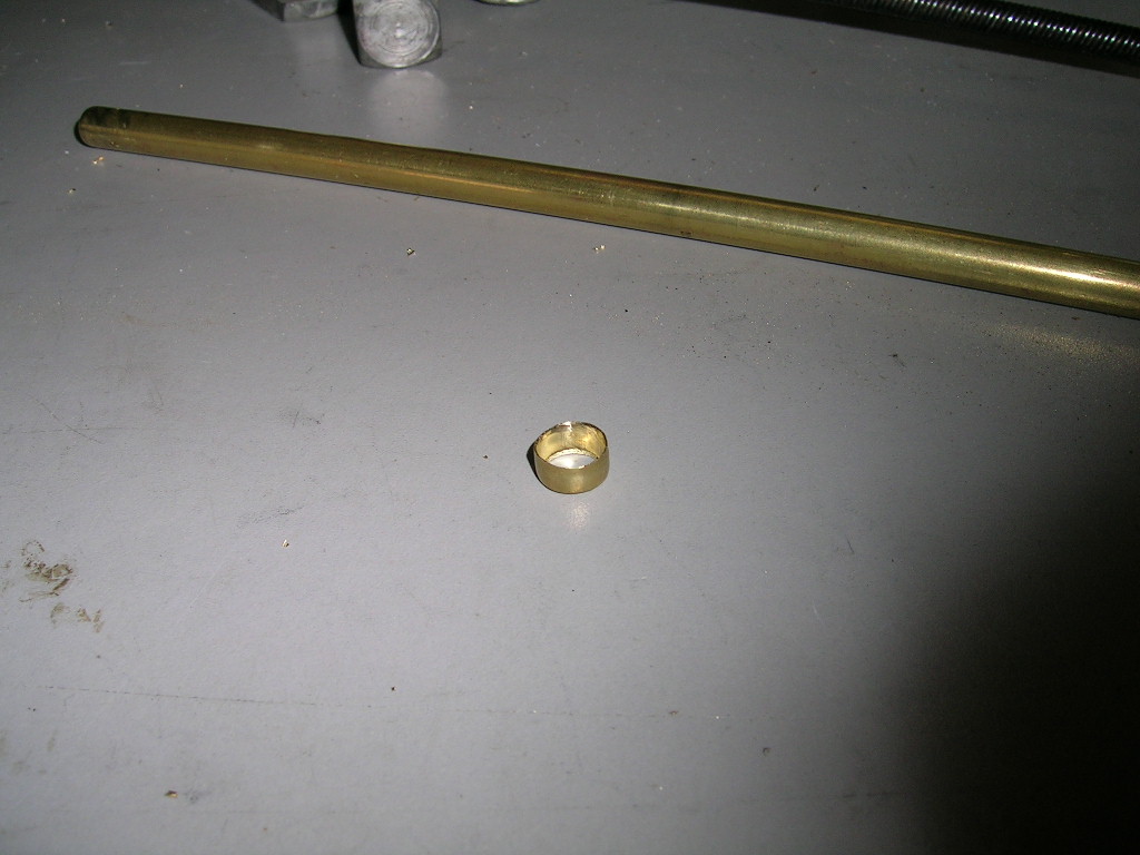

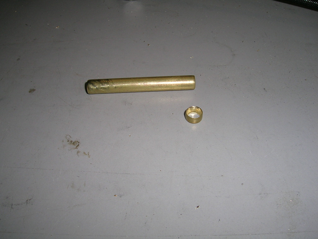

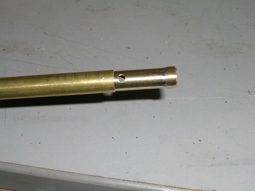

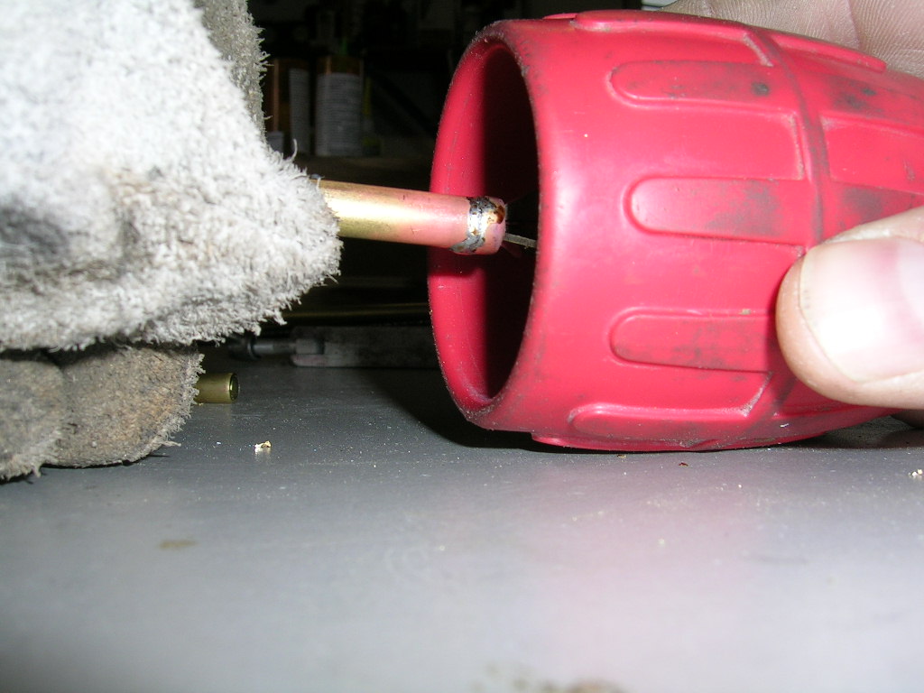

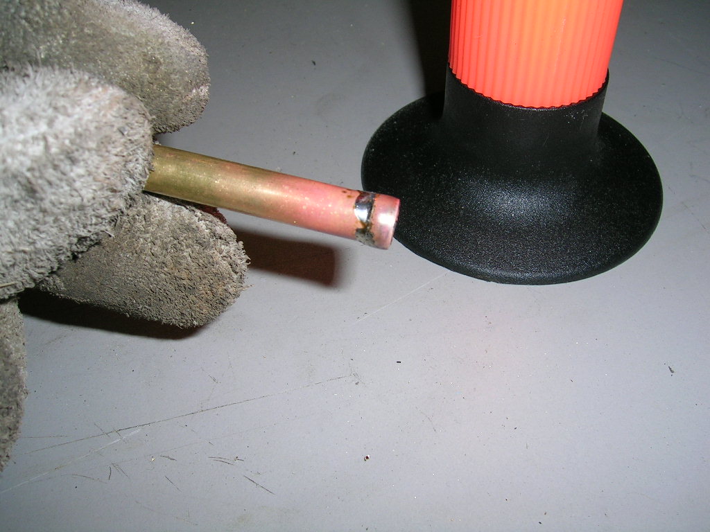

To make bushings without a flaring tool you will follow the same basic steps with the exception of the flaring process. You start with a 9/32" tubing cut to length for the busing. You will also need some 5/16" tubing to make the retaining ring. Cut a piece of 5/16" tubing about 1/8" long. You will have to deburr it and get it to fit over one end of your bushing.
The next step is to solder the ring to the busing. Use a small torch and good quality solder. I like to use Stay Brite silver solder and flux for this. Try not to overheat the bushing. Use only as much heat as is required to get the solder to flow.
Once the ring is soldered and the bushing has cooled, use deburr the ends. Cross-drill and finish up as explained earlier. Then proceed to test fitting in stuffing tube and on prop shaft.
