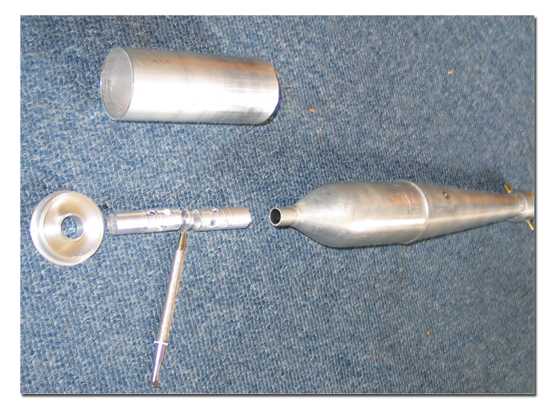

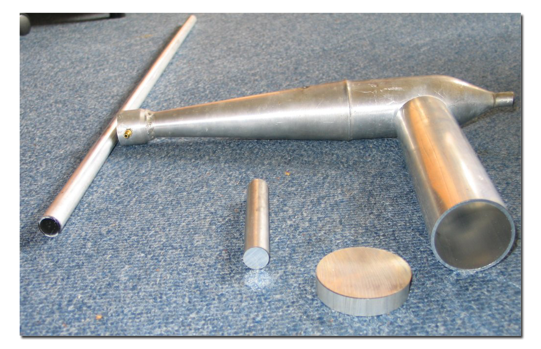

Now I had to go to the metalshop to buy the needed aluminum:
Aluminum-tube : 14mm x 17mm (to fit over the original stinger)
Aluminum-full : 18mm Ø ( to turn a divider between the front and aft baffle pipe)
Aluminum-tube : 52mm x 48mm ( as the outer muffler-wall - 'can')
Aluminum-full : 52mm Ø x 12mm ( to lathe the backplate)
Image Sometimes I get lucky and find the things I need or could use in the metalshop scrap bin or in the leftovers.
So there are parts in this picture that are bigger/longer than needed.
Image All parts made the right size by sawing or turning.
In the tweezer you see the divider.

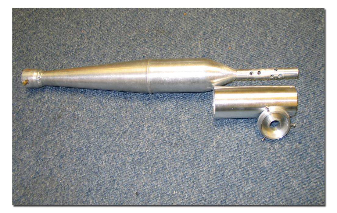

Image This is the view of how the internals fit within the 'can'.
120° drilling and tapping of M3 threads has to be done.
Image 120° drilling and M3 thread-tapping done.

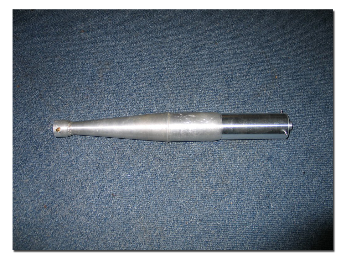

Also reduced the outer diameter of the 'can' on the lathe from 52 to 50 mm.
50mm is the standard European pipe-clamp size.
Image Checking the overall fit , and ready to join by hard-soldering .

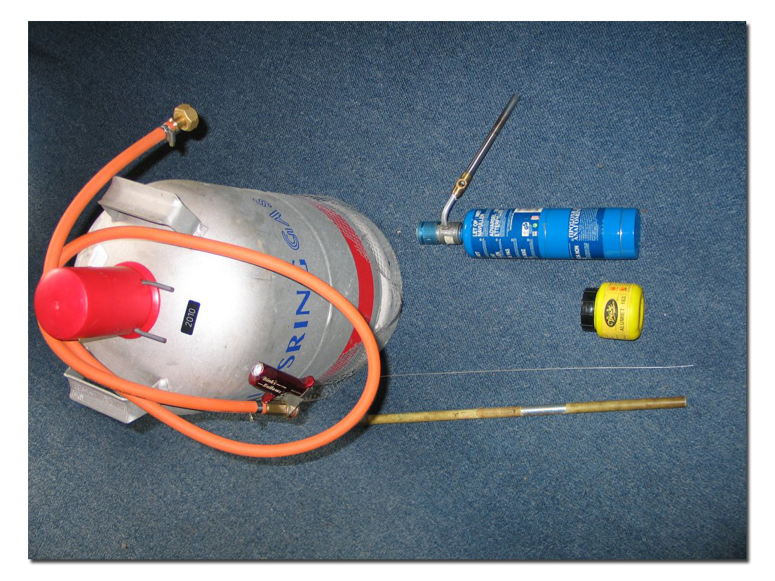

For the brazing a USA made Spitfire propane TurboTorch is used.
LINK for Spitfire/TurboTorch
Recommended by that welder , because of the "spread" of the flame.
Witch is ideal for doing this home DIY soldering.
Generally we hobby-guy's do not have their Acetylene/Oxygen combo's with differend tips.
Image Here you see that a clone propane can is used .... the original Spitfire-TurboTorch can is red.
LINK for clone-propanecan
Also on this picture the flux and the rods and the homemade RV-propane coupler
that is used for time consuming jobs .
And hey ....I'm Dutch ... it's also much cheaper using the RV-propane.

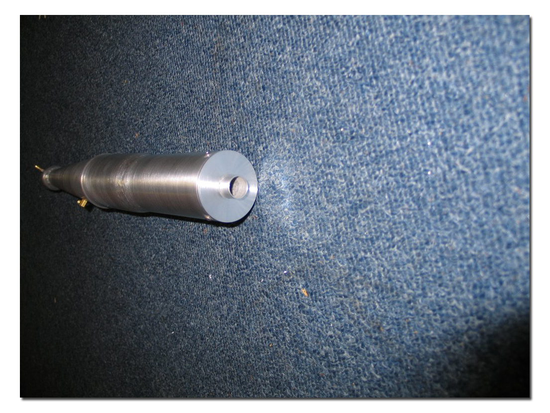

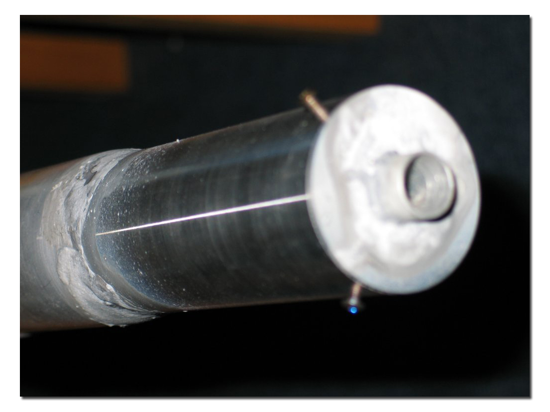

Image Hard soldering done.
You see the joining of the 'can' to the pipe and the muffler-stinger to the backplate.
What you don't see is the joining of the front and aft baffle pipes with the divider.
But that's been done! Smile

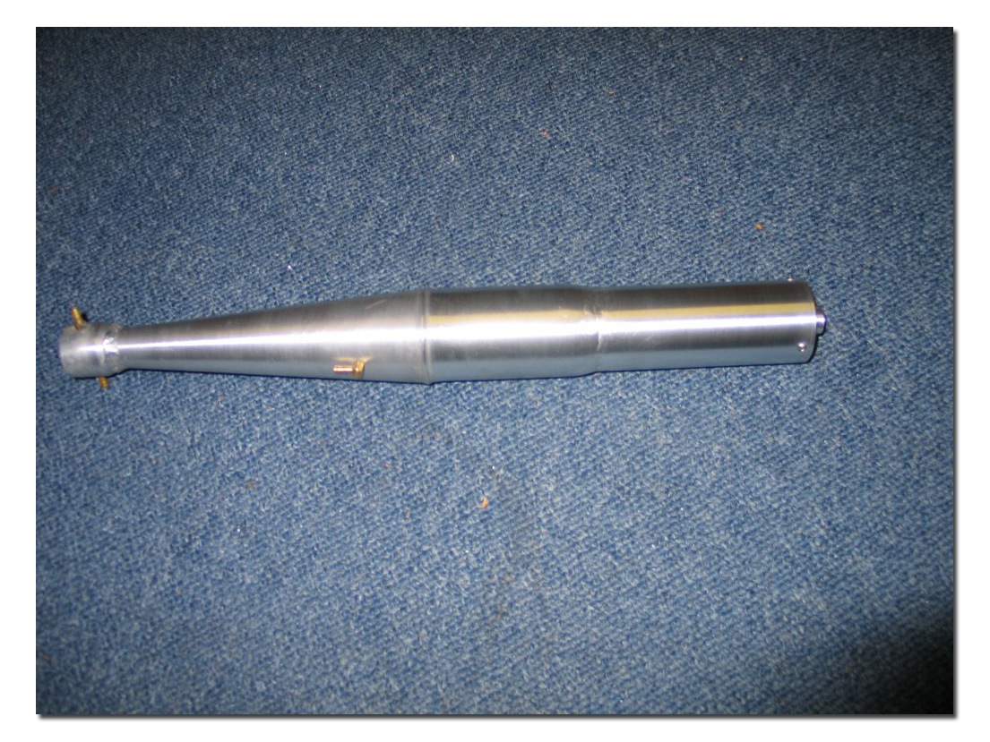

Image View after filing / Dremel'ing / sanding.
Image Same here .... but using the lathe.

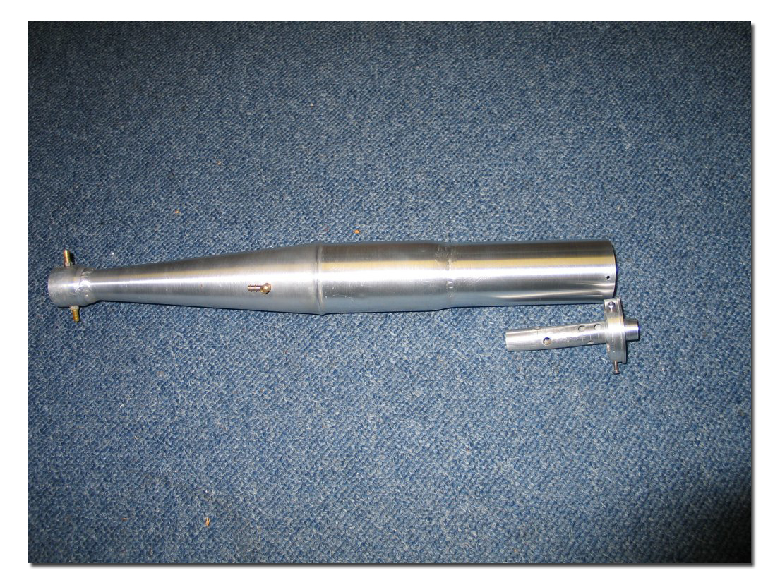

Image Ready for assembling .
As you can see, for cleaning purposes you can take it apart.

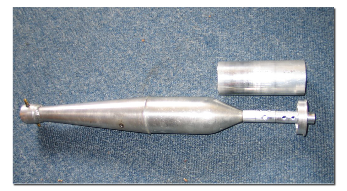

Image But as I dislike cleaning,
I made an oil groove and bore in the outer ring of the backplate
and a bore in the inner-ring out into the muffler-stinger.
After racing you just put the pipe on it's 'back'.
If the noise is still not correct Stainless Steel kitchen scrub can be added.

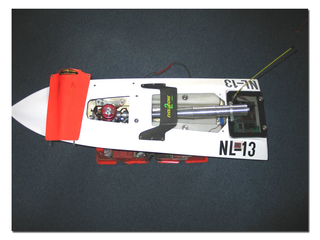

Image Just for display reason: pipe mounted on my FSR-V15 competition racing hull.
And please don't think my hobby room is so clean that it has carpet as you see on the previous pictures...
just to avoid flashback if camera wants to flash the pictures are taken on the floor of my home-office.

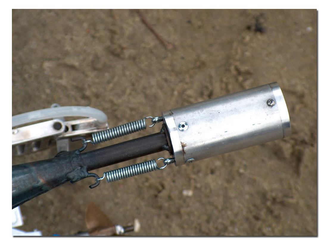

This is an original QD-silencer after rebuilding it .
Notice the little M3 flathead hex-bolts instead of the rivets.
The rest of the story.
I 'dremel'd' away the 'aft' rivets and cut M3 in it .
After opening the content of that thing was ... a tiny roll of 'chickenwire'
and some filthy antinoise-Wool filled with oil.
That muffler was 71,3mm long inside ..the baffle dish is 30mm measured from the front-outside.
The pipe stinger sticks 13mm into the muffler.
At first I did the flow calculations @ 150% stinger Ø .(11mm)
Both for the baffle dish and the baffle tube.
Measuring today 84Db(a) ... with NO loss at all ( No torque NO top).
I could make the flow of the drilled tube = 2nd stage @130% , but the owner is satisfied already .

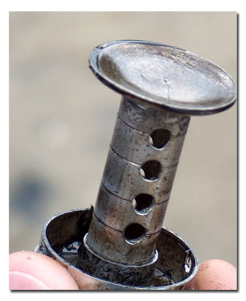

Image And this is how the internals look after the rebuild.
The picture is showing the first one I did, the later rebuilds (and this one later on) got a reinforcing aluminium-ring of 5mm thick so the M3 bolts have more 'meat' on the threads.
The first-stage 150% with the 130% second-stage is measured @ 82Db(a) .
With added SS kitchen scrub in the second-stage part it's measured @ 80Db(a) .
