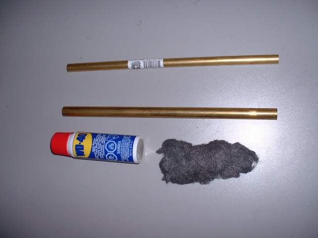

ImageParts needed:
-A small aluminum can (a small 2.3 fl. oz. can of WD40 is great)
-Some brass or copper tubing (size that will fit over stinger of your pipe )
-Some steel wool for added muffling, if desired.

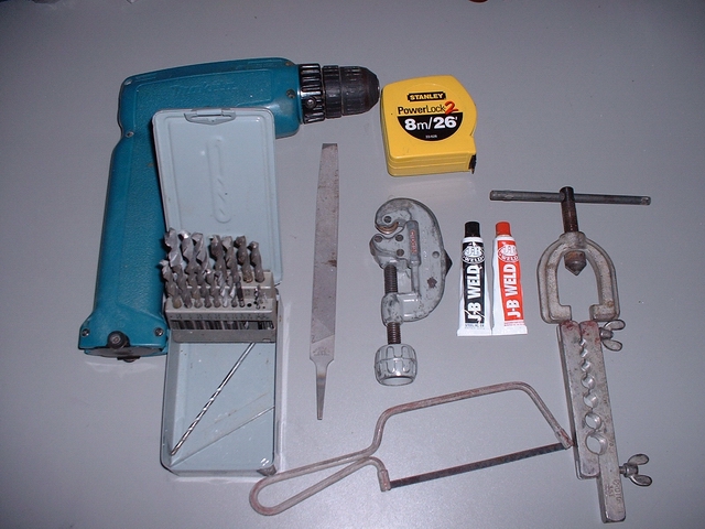

Tools Needed:Image
  • Tubing cutter
  • Drill and drill bits
  • Metal saw (hack saw) or Dremel tool with cutoff wheel
  • Flaring tool (optional)
  • JB Weld epoxy
  • Measuring tape
  • File

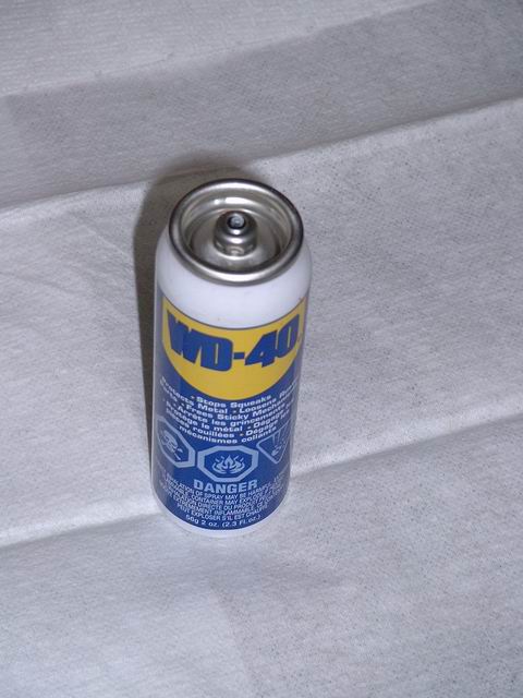

Step 1:

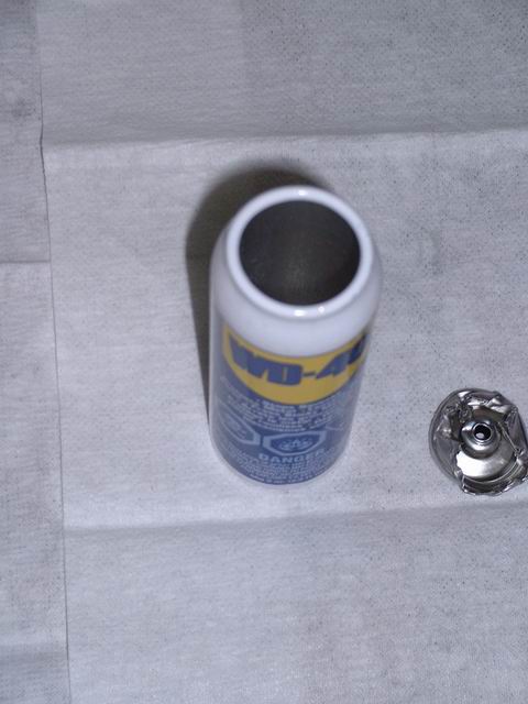

First you have to empty the can of WD-40 (or whatever can you have chosen). Do this before attempting the next step. Caution, there is pressure in the can! Make sure it is completely emptied. I transfer it to another container, and can still use the WD-40! Whatever you do with it, by all means respect our environment, and dispose of the contents appropriately.
Step 2:
Now, start with the top of the can. To remove the valve assembly, simply unfold the lap joint around the top of the can. The entire assembly should all come off rather easily

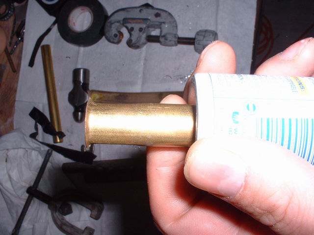

Drill a hole in the bottom of the can the proper size to get a snug fit with the brass tubing you will be using. In this example the tubing is 5/16" O.D. so I drilled a hole of that size. Now is a good time to clean out the can completely using a degreaser. Make sure to remove all drill filings at this time.
Step 4:
Cut the brass or copper tubing about 2 inches longer than the can used. In this case, the can was 4 ¼" long so I cut the tube at about 6". This is done with a tubing cutter, a saw, or a Dremel tool with a cutoff wheel. If you have a flaring tool, flare one end of the tube. This end will be the outlet. If you don't have a flaring tool, it's not a problem and the performance of the muffler will not be affected..

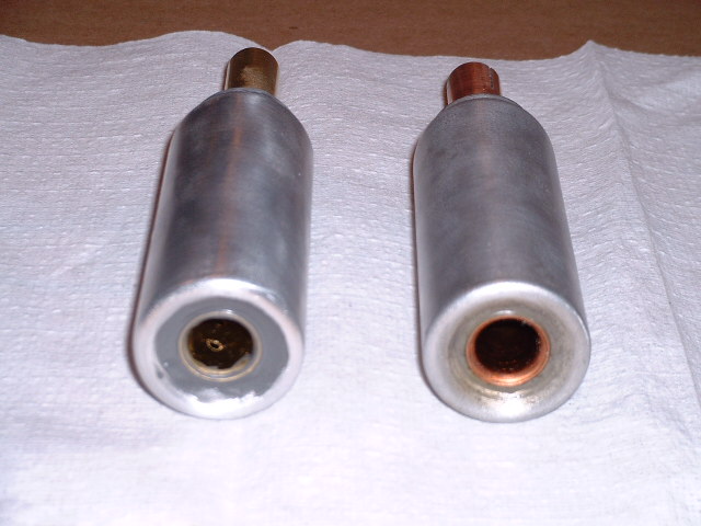

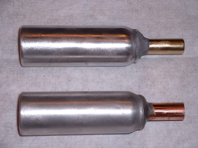

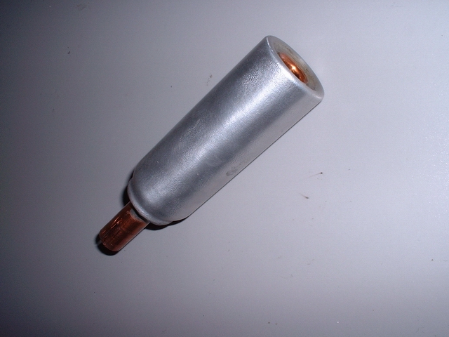

It should look something like this…ENJOY!
