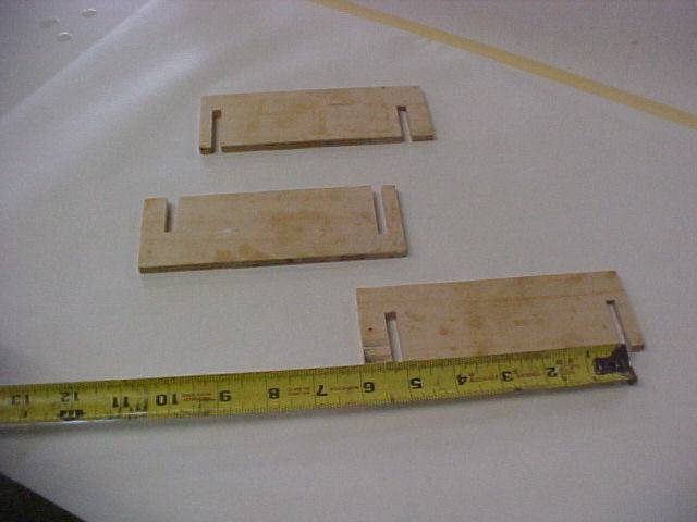

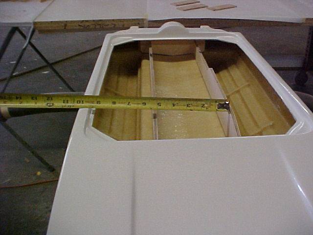

Image3. If possible try to make a pair of holders to help you set your engine rails in place at the desired placement of 5, 5 1/2 or 6" whatever you need. Remember to measure the inside of the rails, not the outside. For instance 5" engine rails would measure 5" between the rails and 51/2" outside of the rails using 1/4" engine rails.

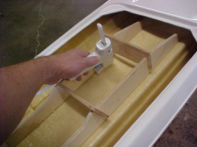

4. The engine rails now need to be put in place, center the rails and push them all the way against theImage transom. A good heavy bead of hot glue on both sides of the engine rails will hold them firmly in place. After the hot glue sets up remove the holders. The rails should stand up right and be firm enough to work on.

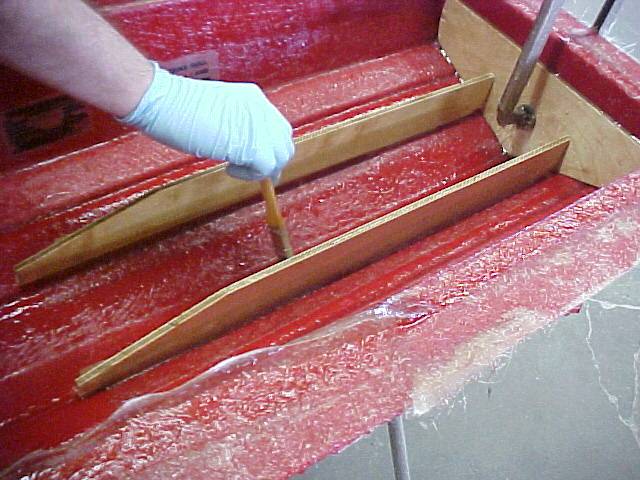

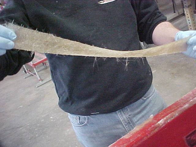

Image5. Cut 4 strips of mat the length of the engine rails. The strips of glass should be about 2 ½" wide. Wet out the strips of mat one at a time, make sure they are fully saturated. A small paintbrush can be used for this. If you let the strips soak to long they will be harder to work with, so it is better to get them wet and install them as quickly as possible.

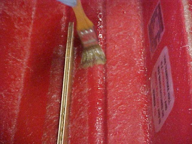

6. Wet out the area of the engine rails where the glass strips will be installed. Cover the wood andImage sanded part of hull completely.

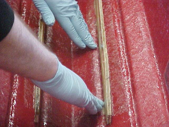

Image7. Place the saturated strips of mat into place in the hull. Lengthwise, half should be on the hull and the other half on the engine rail so as to join the engine rail to the hull.
8. Push the mat into the area and work the air bubbles out with you fingers and a paintbrush. Dabbing is better than brushing because you don't want to pull the mat out of place.
Work the air out by dabbing with your paintbrush and remove any excess resin, wiping off the excesImages on the side of the resin cup. You will have to watch the mat for a little while to make sure that it doesn't lift. Once the resin starts to cure you are home free. Let everything cure completely and start setting up your boat with brand new engine rails!
