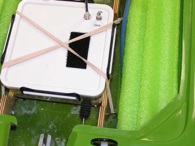

I like to build my boats so the radio box can be easily lifted out of the boat as needed without using any Imagescrews or bolts. My radio boxes are held in place by braces then secured by rubber bands over the box. This example is a simple modification to traditional taped radio boxes which makes use of the securing rubber bands. Instead of taping the small Lexan lid to the radio box, I cut a new lid that was much larger and matched the outer diameter of the radio box. I then applied a strip of Frost King rubber foam weatherseal to the edge of the lid. So when the box is secured in the boat, the rubber bands press down on the lid and create a completely watertight seal. I have tested this radio box in the bath tub and on the pond, and so far it has stayed completely dry.

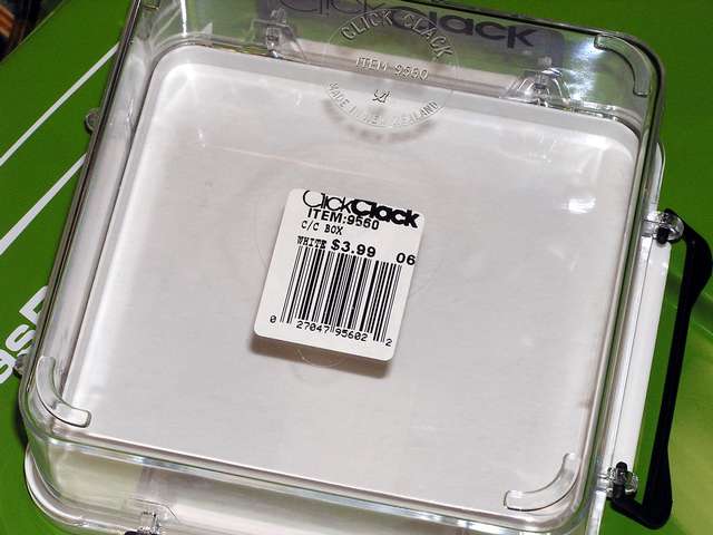

ImageThis other example of a tapeless radio box is a result of my quest to find a less expensive alternative to fiberglass radio boxes. This sandwich storage box is made by ClickClack and sells for $4. The lid on the hard plastic box has a Imagesilicone strip all around it and it is secured to the box by four latches. The latches hold the lid on the box very firmly and create a completely airtight seal. To support the servos inside the radio box and prevent any extra holes, I put a 1/4" piece of wood in the bottom. I coated the wood with a thin coat of epoxy and glued it to the bottom of the box.

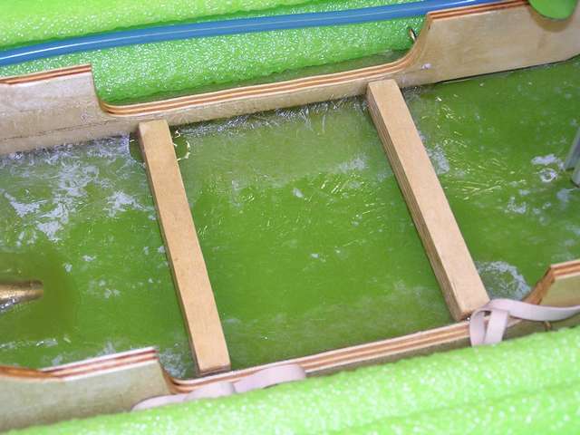

The sandwich box is a little wider than 5 inches, the standard space between the engine rails, so I had to cut the rails down to make room for the box. The box is held in place by two cross beams between the engine rails, and matching blocks glued to the bottom of the box. When the radio box is placed in the boat and held down by the rubber bands, it is rock solid and it does not move. This radio box has also proven to be very durable and completely water tight.
